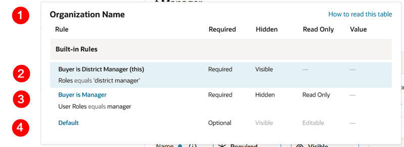

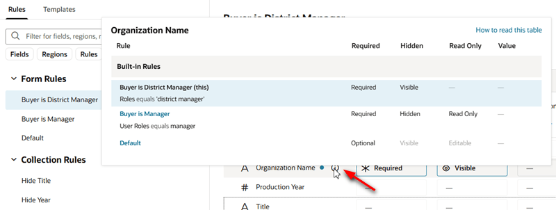

To help you evaluate what will be shown for fields and regions at runtime, the editor provides a pop-up viewer. To display the pop-up viewer, hover over the field or region until you see an info label, then click it:
The pop-up viewer shows all the active rules that modify a region's properties, or a field’s properties within the same region:
Let's take a closer look at the pop-up viewer:
  1. Name of the field (Organization Name) that these rules pertain to.
  2. Currently viewed rule, which is shown with a blue background. The conditions for each rule appears beneath the rule's name.
  3. Another rule. If a rule name appears in blue, you can click it to see all the fields/regions modified by that rule (as opposed to just the selected field).
  4. The Default rule, which specifies the out-of-the-box behavior. The Default rule is always active and cannot be modified. And since it doesn't have any conditions, it will always be considered "true".
