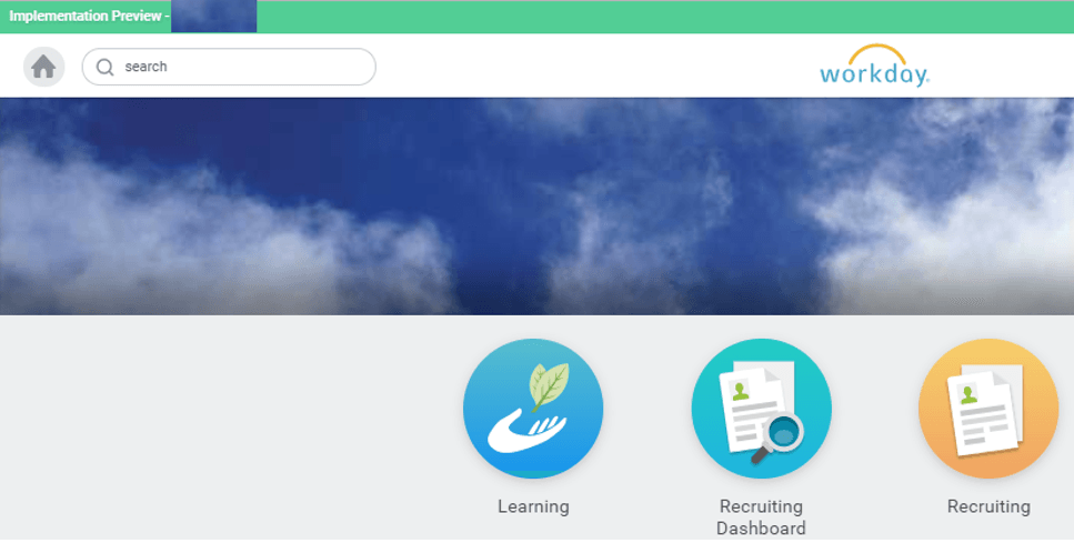

To obtain the tenant name from the sandbox:
  1. Log in to the Workday sandbox.
  2. On the first page, find the tenant details appearing in the upper left corner of the page. The tenant details follow the Sandbox Type – Tenant Name format.
    Description of tenant-sandbox.png follows
