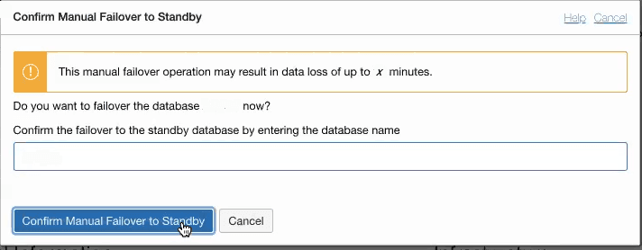

To initiate a manual failover to a cross-region standby:
On the standby database, perform a switchover. See Perform a Switchover to a Cross-Region Standby for details.
If the switchover attempt in Step 1 fails, on the standby database the Role field shows a Failover link. On the standby database, click the Failover link.
This shows the Confirm failover to standby dialog, along with information on possible data loss that may result if you perform the manual failover to the standby database.
In the Confirm failover to standby dialog, enter the Autonomous AI Database name to confirm that you want to failover.
In the Confirm failover to standby dialog, click Failover.
When concurrent operations such as scaling are active, the confirmation also confirms either pausing or canceling the concurrent operation. See Concurrent Operations on Autonomous AI Database for more information.
After the failover completes, Autonomous AI Database reports the time of the last switchover in the Role field on the Autonomous AI Database Details page under Disaster recovery.
