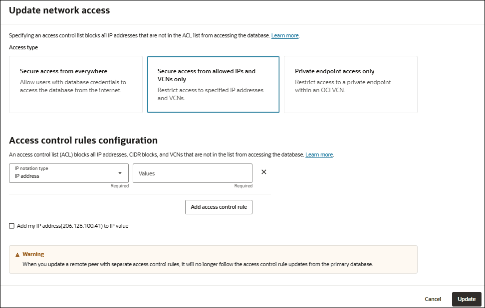

- Configure Access Control Lists When You Provision or Clone an Instance
 When you provision or clone Autonomous AI Database with the Secure access from allowed IPs and VCNs only option, you can restrict network access by defining Access Control Lists (ACLs).
See Provision an Autonomous AI Database Instance for information on provisioning your Autonomous AI Database.
Configure ACLs as follows:

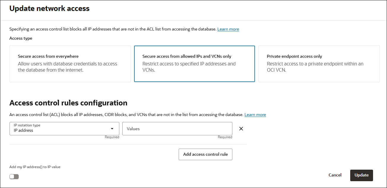

Configure Access Control Lists for an Existing Autonomous AI Database Instance
You can control and restrict access to your Autonomous AI Database by specifying network access control lists (ACLs). On an existing Autonomous AI Database instance with a public endpoint you can add, change, or remove ACLs.
Configure ACLs, or add, remove, or update existing ACLs for an Autonomous AI Database instance as follows:
If the Lifecycle state is Available when you click Update the Lifecycle state changes to Updating until the ACL is set. The database is still up and accessible, there is no downtime. When the update is complete the Lifecycle state returns to Available and the network ACLs from the access control list are in effect.
