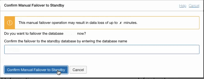

This shows the Confirm failover to peer dialog, along with information on possible data loss that may result if you perform the manual failover to standby.
In the Confirm failover to peer dialog, enter the Autonomous AI Database name to confirm that you want to failover.
In the Confirm failover to peer dialog, click Failover.

This shows the Confirm failover to standby dialog, along with information on possible data loss that may result if you perform the manual failover to the standby database.
In the Confirm failover to standby dialog, enter the Autonomous AI Database name to confirm that you want to failover.
In the Confirm failover to standby dialog, click Failover.
