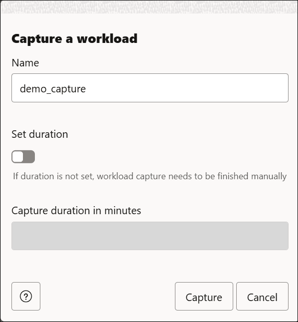

- Click + Capture workload.
- Specify the following field values on the Capture a workload dialog:
- Name: Enter the name of the capture. For example, demo_capture.
- Click Set duration to optionally enter the duration of the capture.
- Capture duration in minutes: Specify this field only when you select the Set duration button, else you can skip this field.
Click Capture to start the workload capture. Click Cancel to cancel the ongoing process of capture.

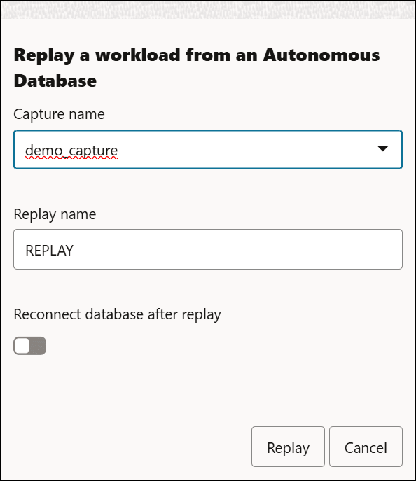

- On the Workload Capture/Replay page, click Replay Workload and select Replay a workload from an Autonomous AI Database.
- Select the capture from the Capture name drop-down field on the Replay a workload from an Autonomous AI Database dialog box.
- Click Replay.
The Workload Capture/Replay page reappears, displays a message that the workload replay has started successfully.

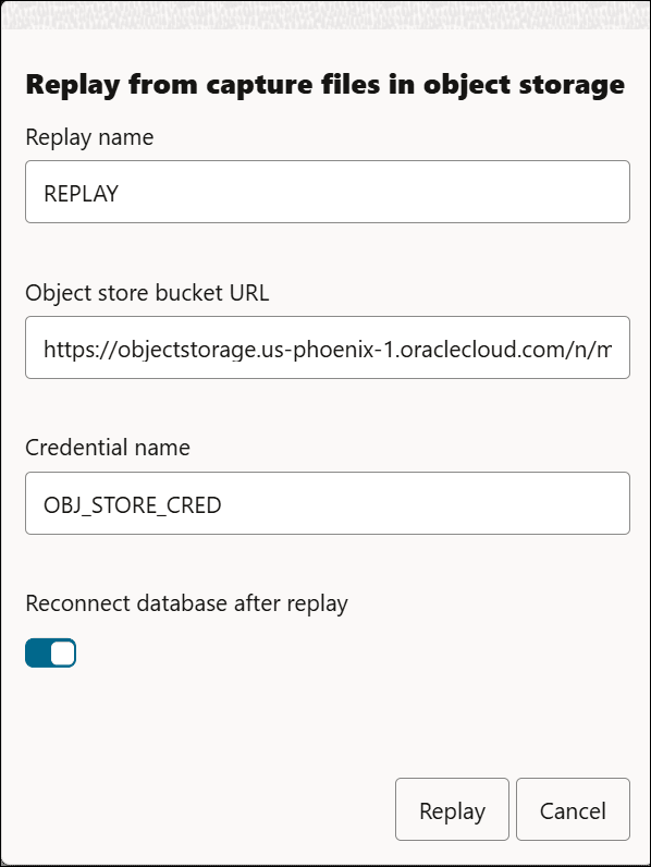

- On the Workload Capture/Replay page, click Replay Workload and select Replay from Object Storage.
- On the Replay from capture files in object storage dialog, specify the following field values:
- Replay Name: Enter the name of the replay. For example, REPLAY.
- Object store bucket URL: Enter the object store bucket URL. For example, https://objectstorage.us-phoenix-1.oraclecloud.com/n/myoci/b/my_bucket/o/.
- Credential name: Enter the name of the credential. For example, OBJ_STORE_CRED. The credential name must conform to Oracle object naming conventions, which do not allow spaces or hyphens.
- Select Reconnect database after replay to reconnect database after replay.
Click Replay.
