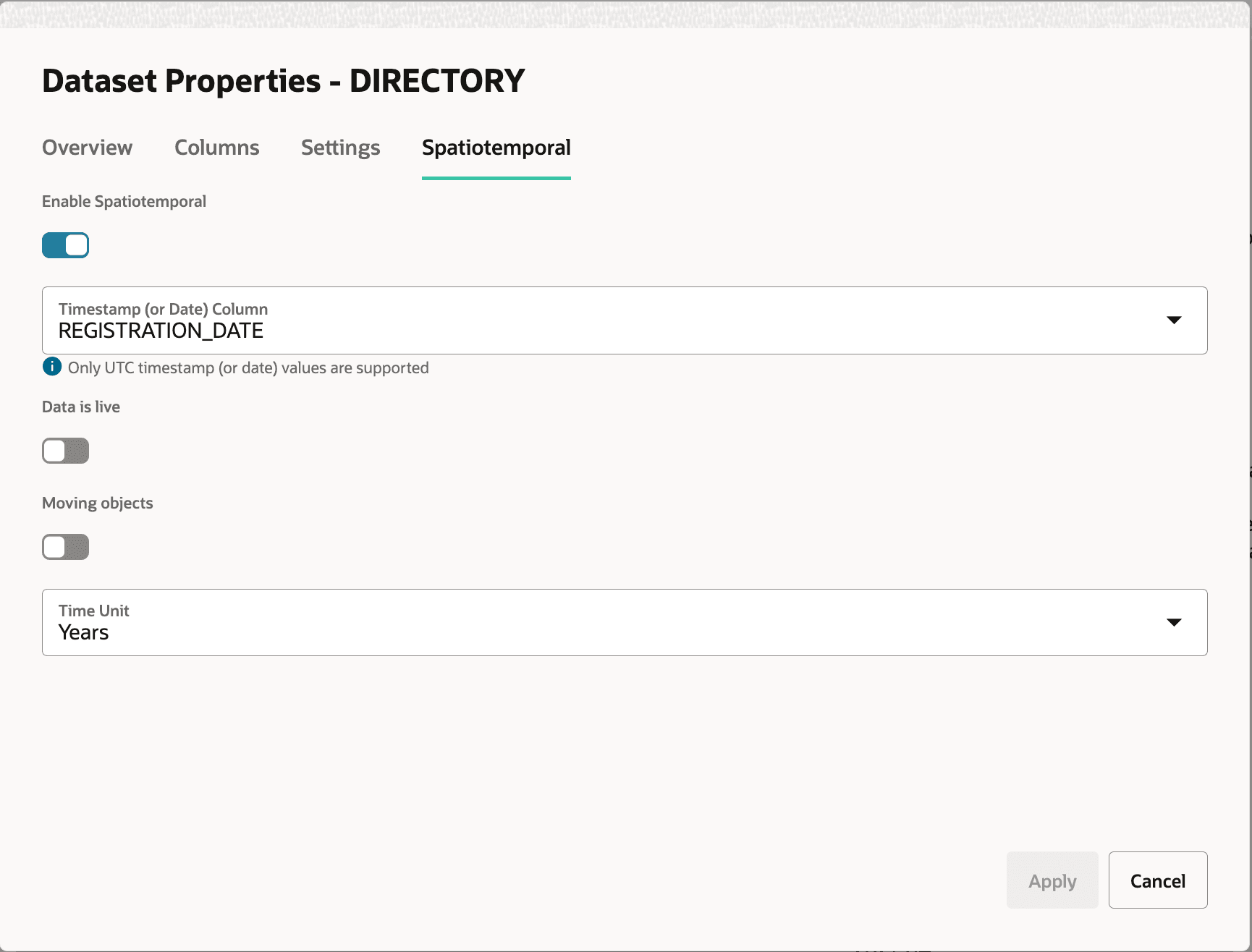

    The following dialog is displayed:
  4. Switch ON Enable Spatiotemporal.
  5. Select the Timestamp (or Date) Column.
    • Both date-type and timestamp-type columns are supported.
    • If using a timestamp-type column, then note that Spatial Studio supports only UTC (Coordinated Universal Time) or GMT (Greenwich Mean Time) time zone for visualizing moving objects.
  6. Switch OFF Data is live.
  7. Switch OFF Moving objects.
  8. Select the Time Unit.
    The data will be filtered as per the selected time unit.
    Also, note that the filtering is applied at the dataset level. This implies that all the layers created out of this dataset will have the same filtering when added to the timeline.
  9. Click Apply.
Your dataset is now enabled for spatiotemporal data visualization.
