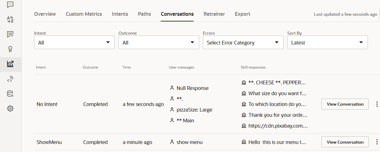

Because
of the insightsEndConversation: true property, Insights considers any
further interaction enabled by the pizza, pasta, or
textReceived transitions as a separate conversation, meaning that
two conversations, rather than one, are tallied in Overview page's Conversations metric
and likewise, two separate entries are created in the Conversations report.

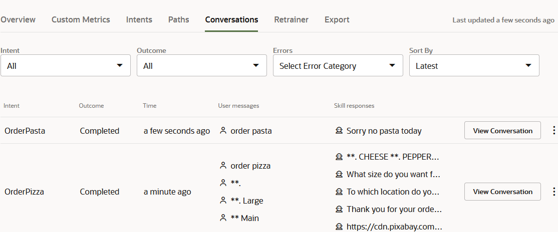

Keep in mind that conversation counts will be inconsistent with those tallied prior to adding this property.ShowMenu state.The second is the transition-specific entry that names an intent when the
textReceived action has been triggered, or notes No Intent when
there's no second intent in play. When you choose either Pizzas or Pastas from the list
menu rendered for the showMenu state, the Conversation report contains
a ShowMenu entry and a No Intent entry for the transition conversation because the user
did not enter any text that needed to be resolved to an intent.However, when you trigger the
textReceived transition by
entering text, the Conversation report names the resolved intent (OrderPizza,

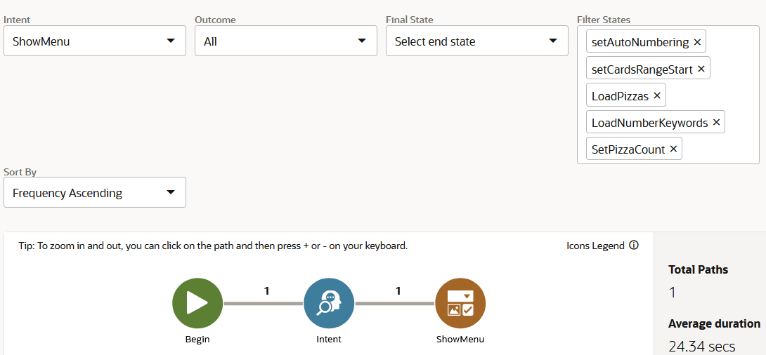

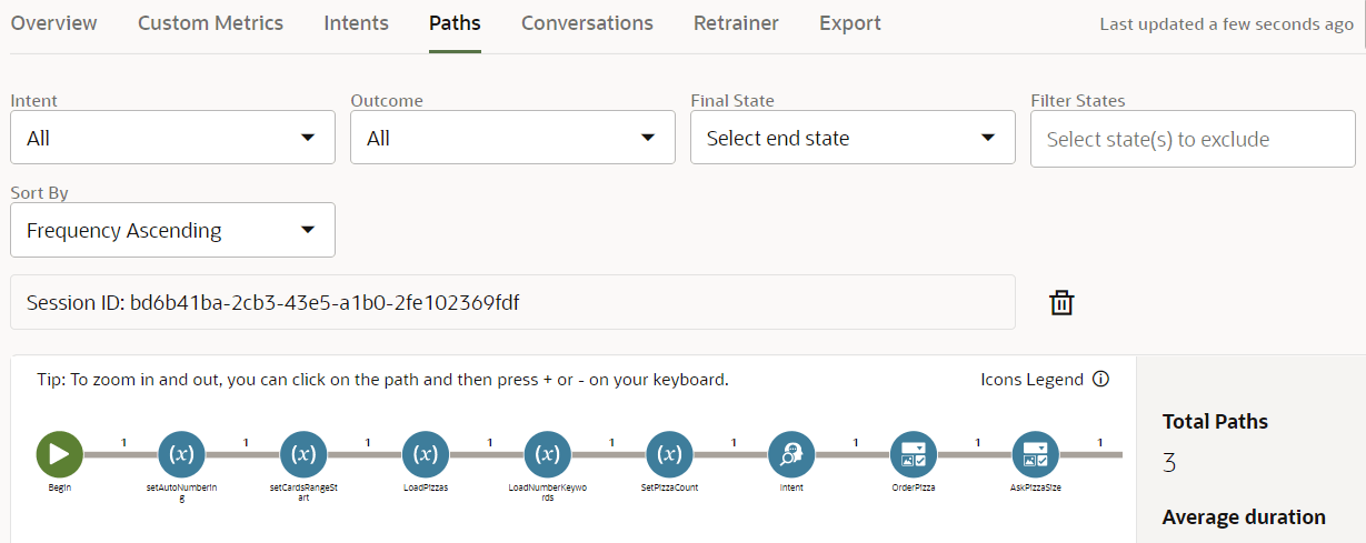

OrderPasta). Use Case 2: You Want to Exclude Supporting States from the Insights Pathing Reports
The
You can add the
states node of the CrcPizzaBot skill begins with a series of
System.SetVariable states. Because these states are positioned at
the start of the definition, they begin each path rendering when you haven't excluded
them with the Filter States option. You may consider supporting states like these as
clutter if your focus is instead on the transactional aspects of the path. You can
simplify the path rendering manually using the Filter States menu, or by adding the
insightsInclude: false property to the dialog flow definition.

...For
the CRCPizzaBotSkill, adding the insightsInclude: false property to
each of the System.SetVariable states places the transactional states
at the start of the path.Note:
Adding theinsightsInclude: false property not only changes how the paths
are rendered, but will impact the sum reported for the Average States
metric.
