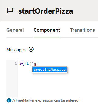

Resource Bundles and the Visual Flow Designer
You can use resource bundles to store any user-visible strings that you add to your dialog flow.
You reference resource bundle message keys through the variable
rb. A reference to a simple resource bundle message takes either of
the following two forms:
${skill.system.rb.RB_ENTRY_NAME}${rb.RB_ENTRY_NAME}
Tip:
Autocompletion helps you select the resource bundles referenced in Apache FreeMarker expressions.Modify a Resource Bundle Entry
- In the skill, click
to open the Resources Bundle.
- Select the Configuration tab.
- Using the Filter field, navigate to the entry that you want to update.
- Mouse over the value for the key and select the
icon that appears.
- In the Text field, enter the updated message.
- Click Update Entry.

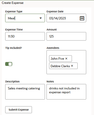

User Input Form Messages
In dialog flows, you can also create create input forms.
Sometimes an input form is the quickest and least error-prone way of collecting user
information. Rather than a subjecting users to a volley of questions, your skill can guide
users to providing valid input by sending them forms that contain input elements like text
input fields, time and date pickers and toggle switches.
- From the Add State dialog, choose User Messaging > Create Tables and Forms. Then choose Create Input Form.
- To create the form's layout, actions and editable and read only fields, first click
Edit Response Itemsand then edit theResponseItemsmetadata template. In this case, the template is for theeditFormresponse item.responseItems: - type: editForm title: Input Form formColumns: 2 items: - autoSubmit: false displayType: textInput defaultValue: "${(submittedFields.value.myText)!''}" multiLine: false minLength: 5 name: myText label: Text placeholder: Enter free text clientErrorMessage: Field is required and must be between 5 and 50 characters required: true maxLength: 50 - validationRegularExpression: "^[a-zA-Z\\s]*$" autoSubmit: false displayType: textInput defaultValue: "${(submittedFields.value.myTextArea)!''}" multiLine: true name: myTextArea label: Text Area placeholder: Enter free text clientErrorMessage: Numbers are not allowed - autoSubmit: false displayType: datePicker minDate: "1970-01-01" defaultValue: "${(submittedFields.value.myDate)!''}" name: myDate maxDate: "${.now?iso_utc[0..9]}" label: Date placeholder: Pick a date in the past clientErrorMessage: Date is required and must be in the past. required: true - autoSubmit: false maxTime: "12:00" displayType: timePicker minTime: "00:00" defaultValue: "${(submittedFields.value.myTime)!''}" name: myTime label: Time placeholder: Pick a time in the morning clientErrorMessage: Time must be in the morning. required: false - autoSubmit: false displayType: numberInput minValue: 5 maxValue: 500 defaultValue: "${(submittedFields.value.myNumber)!''}" name: myNumber label: Number placeholder: Enter a number between 5 and 500 clientErrorMessage: Number is required and must be between 5 and 500. required: true - autoSubmit: false displayType: singleSelect defaultValue: "${(submittedFields.value.mySingleSelect)!''}" name: mySingleSelect options: - label: Label 1 value: Value 1 - label: Label 2 value: Value 2 - label: Label 3 value: Value 3 layoutStyle: list label: Single Select clientErrorMessage: Field is required required: true - autoSubmit: false displayType: multiSelect defaultValue: "${(submittedFields.value.myMultiSelect?join(','))!''}" name: myMultiSelect options: - label: Label 1 value: Value 1 - label: Label 2 value: Value 2 - label: Label 3 value: Value 3 layoutStyle: list label: Multi Select clientErrorMessage: Field is required required: true - displayType: toggle defaultValue: "${(submittedFields.value.myToggle)!'true'}" name: myToggle labelOn: "Yes" label: Toggle valueOff: "false" labelOff: "No" valueOn: "true" actions: - label: Submit type: submitForm channelCustomProperties: - channel: "${system.channelType}" properties: replaceMessage: "${system.message.messagePayload.type == 'formSubmission'}"

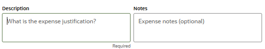

- The editable fields share a set of common properties, including the
autoSubmitproperty. This is an optional property, but enabling it (autoSubmit: true) allows the form to submit a field value before the user has actually submitted the entire form. You can use this property for interdependent fields within your form. For example, you can set this property when the display of one field depends on a value entered in another field, or when a value set for one field restricts the input allowed in another field.Note:
Microsoft Teams does not supportautoSubmit. - The optional
clientErrorMessageproperty sets the field-specific error message that displays when there is limited client-side validation or when client-side validation fails. For example, for messages sent through the Slack channel, this property is only supported when the form is within the conversation page. It does not display when the form message is in a modal dialog.Note:
This property is mainly intended for Microsoft Teams adaptive cards, which limits you to use a single message for all different field-level errors.

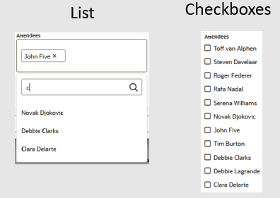

| Multiselect List | A list that supports multiple selections. You can
style this component as a pick list that users can filter and select
from, or as a set of checkboxes. |
Yes |

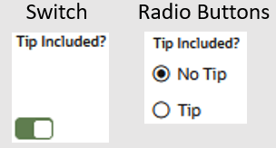

| Toggle | Presents a toggle switch (or a radio button grouping,
depending on the channel) for two options. |
Yes |

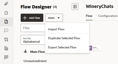

Import and Export Flows
You can import and export Visual Mode dialog flows using the Import Flow and Export Selected Flow options from the More menu.

...Import Flows
You can import a flow by clicking More > Import
flow and then browsing to, and selecting, a YAML document formatted for
the Visual Dialog Mode. These flows can be the YAML documents generated when you export
a dialog flow (the ones with names formatted as <skill name> - <flow name>
-Flow.yaml ), or they can be the YAML files located in the
dialogs folder of an exported ZIP file for a skill built using
Visual Dialog Mode. You can't import an OBotML document directly. You must migrate the skill first.
- You can't import a main flow (the
System.MainFlow.yamlfile located in thedialogsfolder of an exported ZIP file for a Visual Dialog Mode skill. - You can't import a flow that already exists in the skill or in your
instance. If the flow already exists, you can upload the YAML document by
changing the value for the
namenode.
However, you may instead want to duplicate the flow (Menu > Duplicate Selected Flow) rather than edit the YAML.name: "WineryChats" trackingId: "D6BFE43B-D774-412A-91F6-4582D04B3375" type: "task" ...
