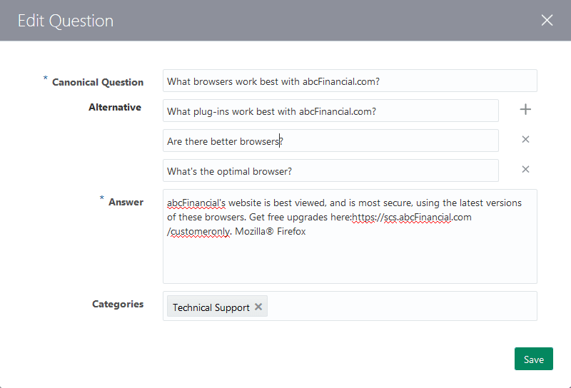

Add Questions and Answers One-by-One
  1. In the Data Sources tab, click on the data source.
  2. Click View All Q&A.
  3. Click Add Question.
  4. Complete the dialog as follows and then click Create.
    • Canonical Question—Enter the question that displays by default in the chat.
    • Alternative—Add one or more variations on the canonical question. Keep in mind that you just need to focus on how users might ask the same question in different ways, not on accommodating synonyms or common misspellings.
    • Answer--Add a concise answer. In place of a lengthy explanation, add a URL that points users to more detailed information. This URL will render as plain text in the tester window, but will render as a hyperlink when the skill runs on an actual messaging platform.
    • Categories—If applicable, enter a category or choose one from the menu. (The menu is populated with the categories from your data source file).
    • For hierarchies, enter a string with forward slashes (/).
      This is an image of the categories field.
    • Create another—Select this option to open a new dialog after you click Create.
  5. Retrain Q&A.
  6. Click Close in the Data Sources tab.

Edit Questions and Answers One-by-One
Even though most of your content development is done using the source file itself, you can add updates using the Data Sources tab.
  1. In the Data Sources tab, page to the question, or locate it using one of the search fields (categories and question and answers).
  2. Hover over the question and then click Edit.
  3. Use the Edit Question dialog to:
    • Change the canonical question.
    • Add more alternative questions.
    • Edit the answer.
    • Add or remove categories.
  4. Click Save.
  5. Retrain the Q&A module.
