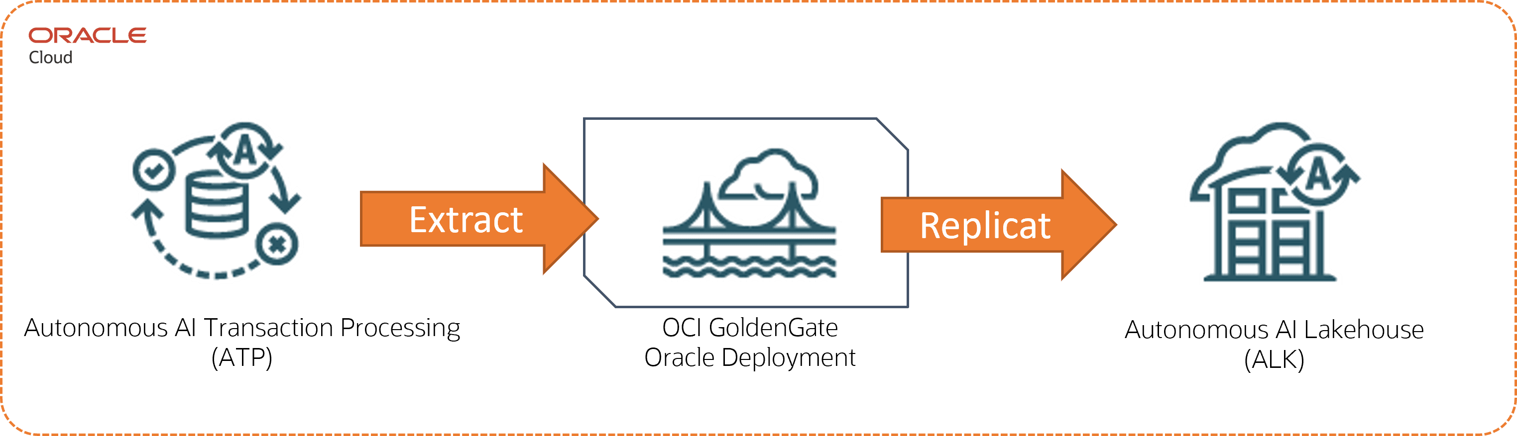

To determine how many deployments your solution needs, consider the types of technologies you’re replicating data between.
For example, if your source and target databases are Autonomous AI Databases, then you need only one Oracle deployment type.
See Replicate data between cloud databases in the same region.

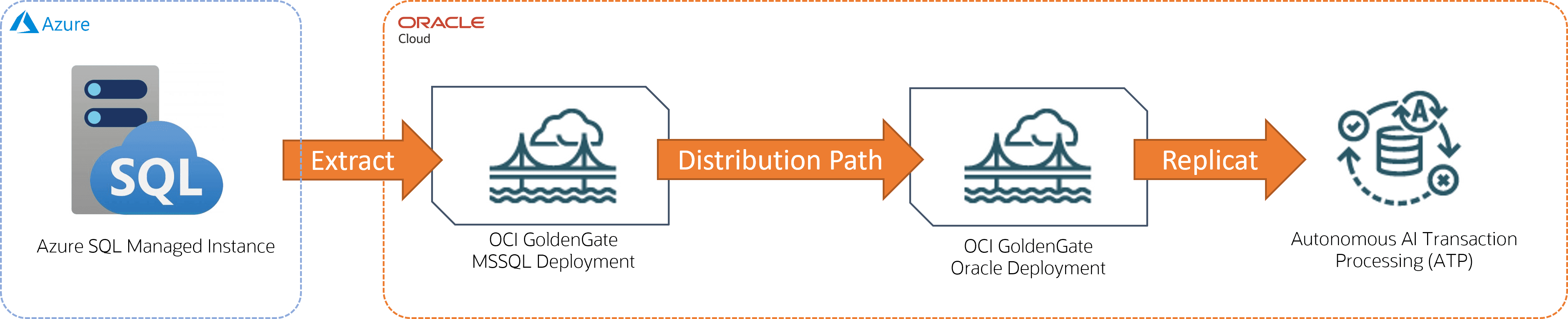

Example: Azure SQL Managed Instance to Autonomous AI Transaction Processing
In this example, Azure SQL Managed Instance is the source technology and Autonomous AI Transaction Processing (ATP) is the target.
For this replication scenario, you need:
Two deployments:
A Microsoft SQL Server deployment for the source database
An Oracle deployment for the target database
Connections:
A connection to Azure SQL Managed Instance, and then assigned to the Microsoft SQL Server deployment
A connection to Autonomous AI Transaction Processing, and then assigned to the Oracle deployment
Processes:
An Extract process created in the source deployment
A Distribution Path created in the source deployment
A Replicat created in the target deployment
This replication scenario is available as quickstart.

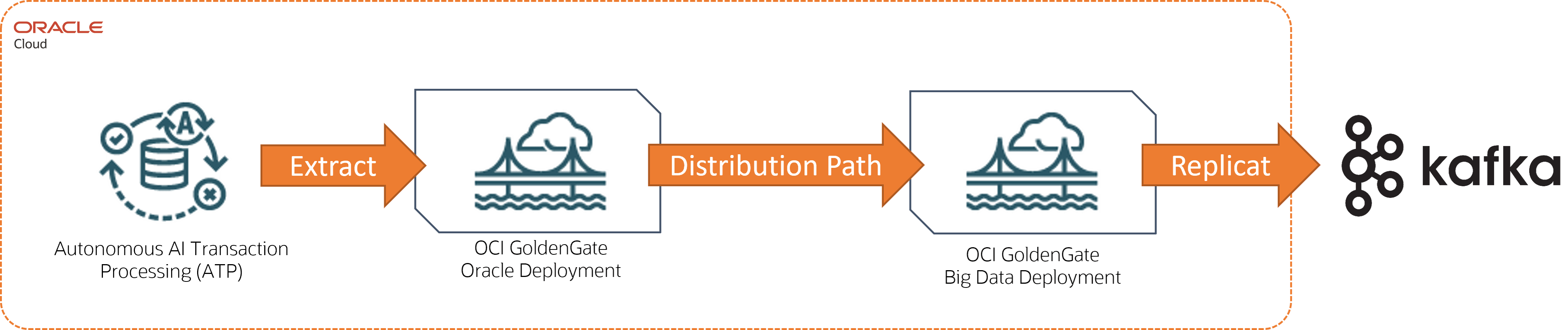

Example: Autonomous AI Transaction Processing to Apache Kafka
In this example, Autonomous AI Transaction Processing (ATP) is the source technology and Apache Kafka is the target.
Two deployments:
An Oracle deployment for the source database
A Big Data deployment for the target technology
Connections:
A connection to Apache Kafka, and then assigned to the Big Data deployment
Processes:
This replication scenario is available as a quickstart.

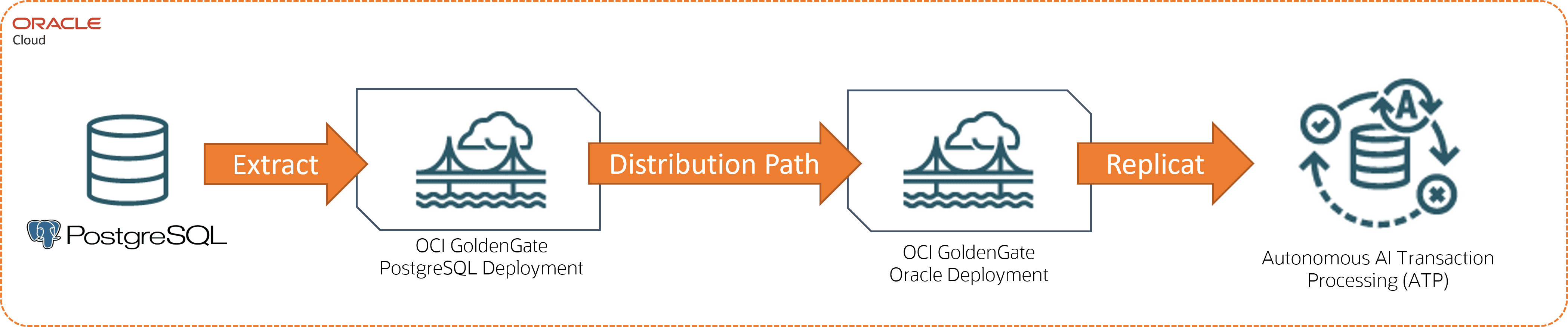

Example: PostgreSQL to Autonomous AI Transaction Processing
In this example, PostgreSQL is the source technology and Autonomous AI Transaction Processing (ATP) is the target.
Two deployments:
A PostgresSQL deployment for the source database
An Oracle deployment for the target technology
Connections:
A connection to PostgreSQL, and then assigned to the PostgreSQL deployment
Processes:
