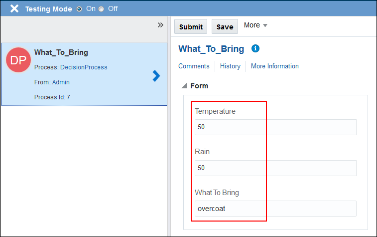

  4. In the form, enter temperature and rain values, and click Submit.
  5. Click My Tasks and open your new task. The What To bring field displays the decision’s result based on the values you entered.
