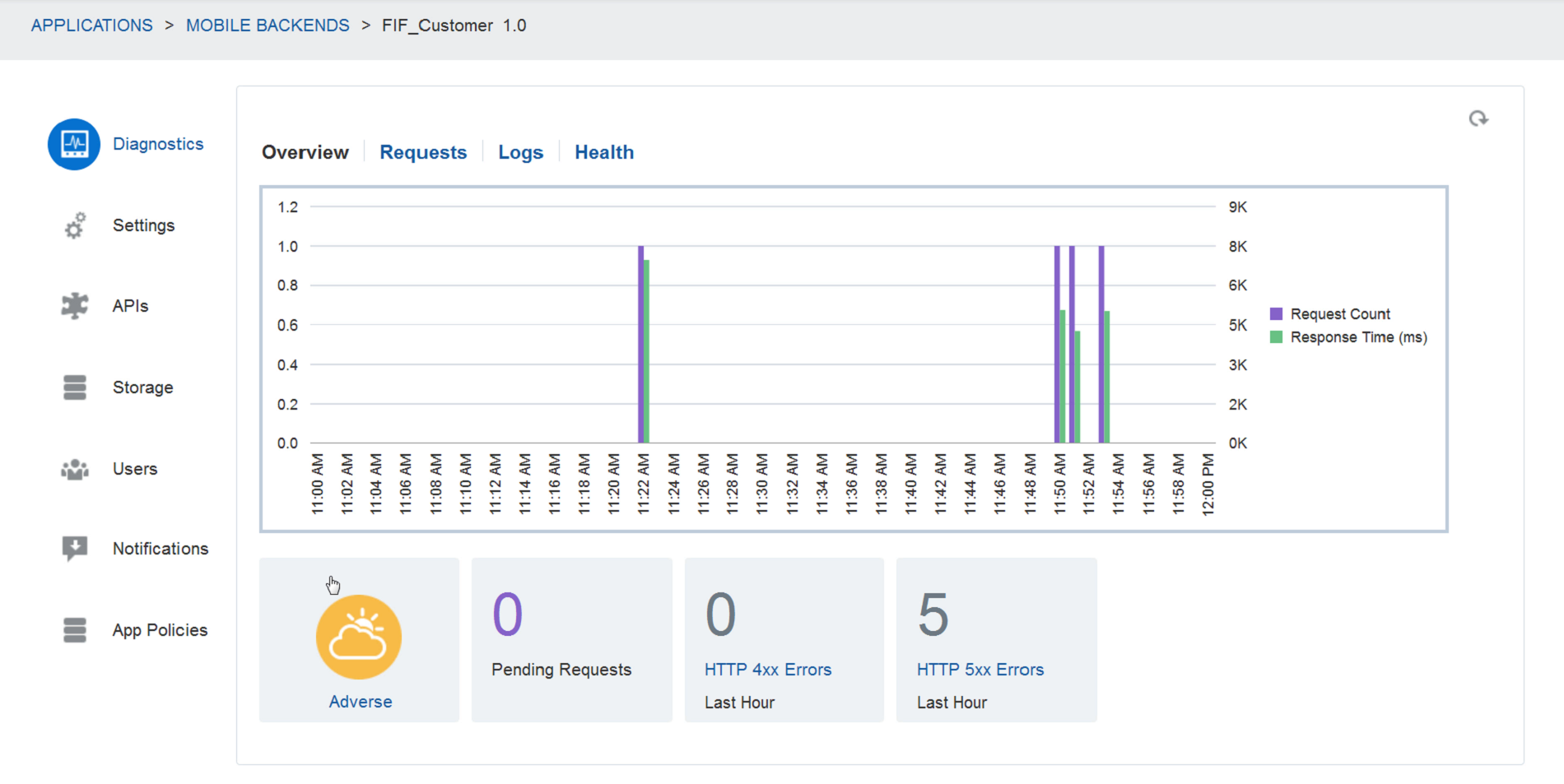

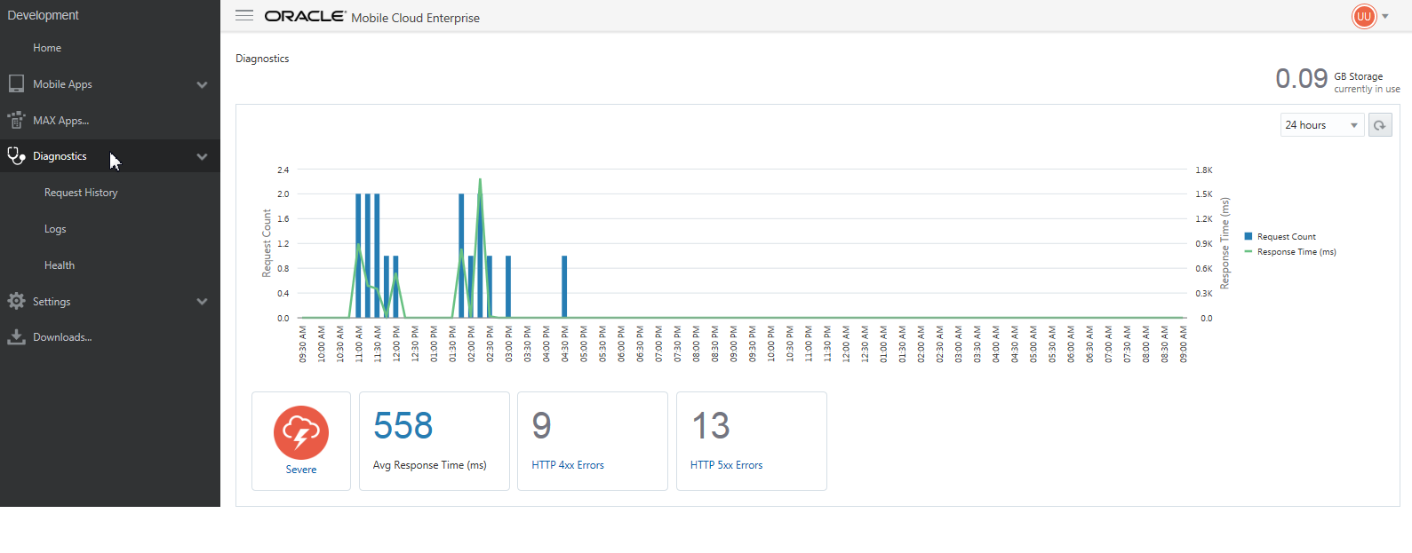

Viewing Environment Health
The green, amber, and red traffic light indicators on the Diagnostics page depict the overall health of an environment for the last hour, or other selected time period.
AMCe bases this at-a-glance view on the fine-grained health metrics for that environment. When the percentage of error responses exceed configured thresholds for the selected time period, the traffic light indicator changes from green (normal) to amber (warning) or red (severe).
The time period for analysis can be changed using the menu, with additional choices for 2, 6, 12, or 24 hours.
Viewing Server Load
As part of the overall portrait of health at any given moment, the Diagnostics page includes a timeline that plots a recent history of the number of requests and response times.
Viewing Errors
The Diagnostics page notes the number of client (4xx) and server (5xx) errors that have occurred within the last hour or other selected time period. See Viewing Status Codes for API Calls and Outbound Connector Calls.

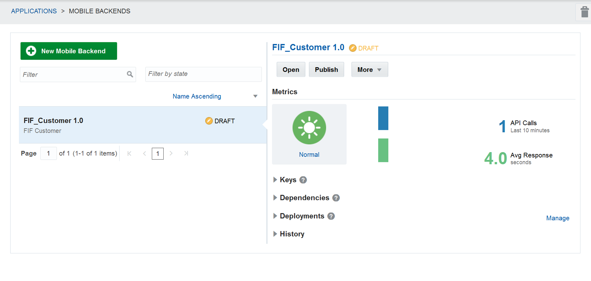

Monitoring a Selected Backend
The backend’s summary page gives you a snapshot of the current health of its environment. You can take a deeper look at request and response processing and error handling by selecting the backend and then clicking Open.
The Diagnostics page displays the number of the requests and responses, plots them on a timeline, and notes the number of client and server (4xx and 5xx) errors. Because this page gives you a snapshot of the overall health of a backend, you can focus your attention where it's needed: on specific performance issues or problems with the API implementations and connectors used by the backend.
While you can drill down through the Overview page to specific endpoint data, you can also view detailed API request and error information using the Health, Request History, and Logs pages.

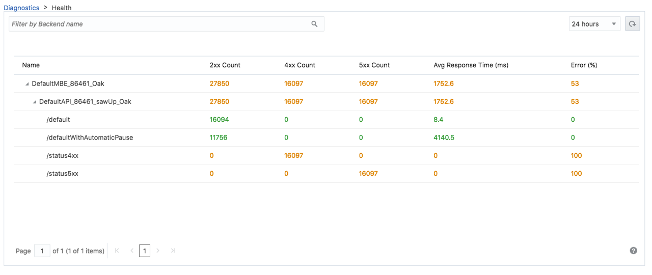

Viewing API Performance
You can find out how the performance of a specific API contributes to the overall health of a backend or to an entire environment. For each API, AMCe records the same error and request handling metrics that it applies to a backend. You can drill down to see how the API endpoints behave in terms of these performance metrics.
From Diagnostics, click Health to view the APIs for a backend . You can also open this page by clicking the traffic light indicator on the Diagnostics page. If the traffic light indicator is amber or red, then you can quickly investigate the cause of the problem by using the Health page.

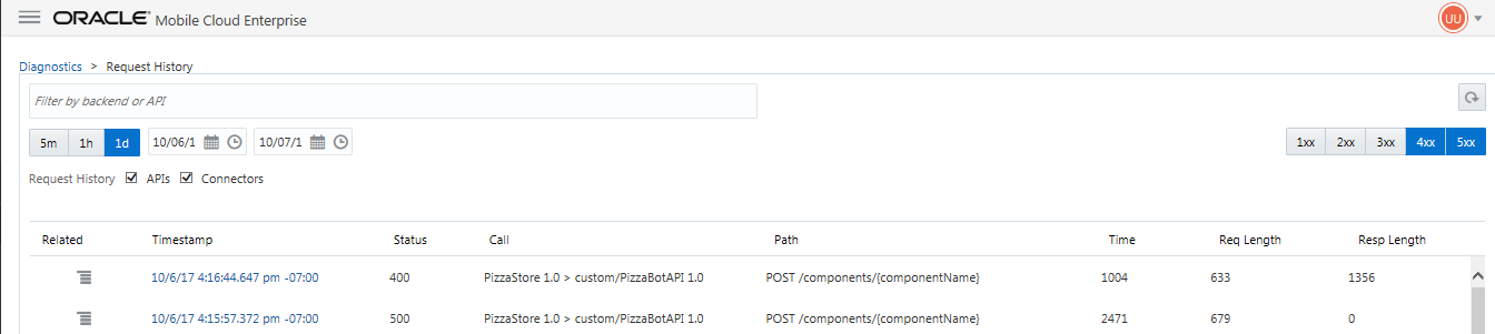

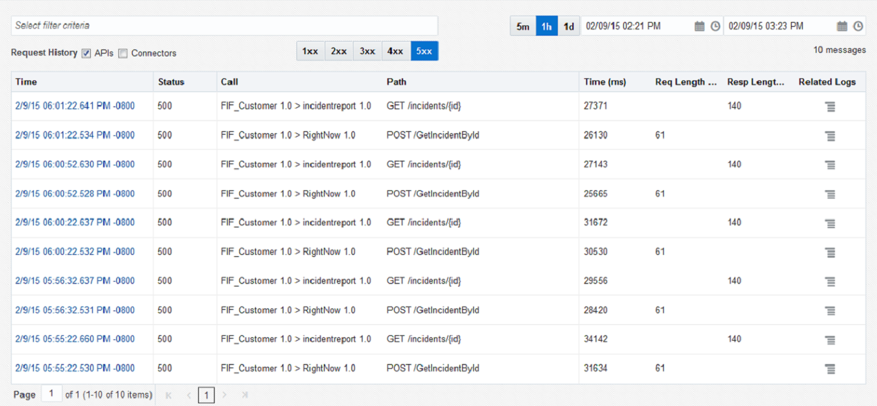

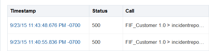

When you open the Request History page, its 4xx and 5xx status code buttons are selected by default, displaying the client (4xx) and server (5xx) HTTP status codes for the API's endpoints and the outbound connector calls made within a single backend (if you're a developer) or across all backends (if you're an administrator). This page gives you a glimpse into the context of the status code, letting you trace the causes for various status codes.
Tips:

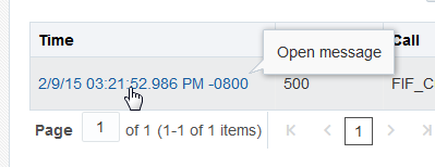

Clicking the time stamp opens the message itself.
See Viewing Message Details
You can learn more about the API call or outbound connector request by looking at the page's Call and Path columns, which show you a description of the targeted resource as well as the action and object of the request.
The table that lists the calls displays the sizes of the request and response in bytes as well as the response time. If a slow response time might indicate a problem, then you can troubleshoot the issue using correlation. See Viewing Log Messages Related to a Request.

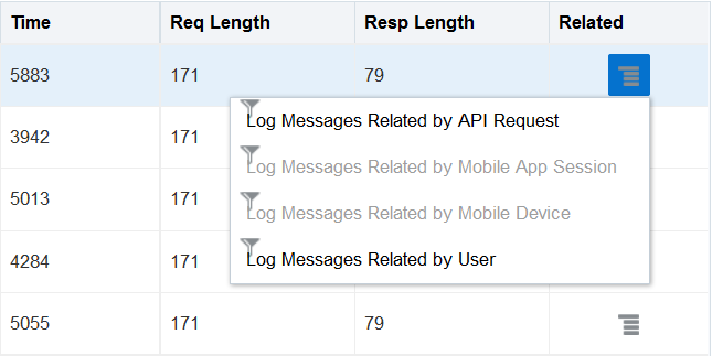

For each request, you can use correlation to get the logging data to a request by using the options in the Related Logs column. You can correlate log records by app session, mobile device, user, and API request.
To query a list of log records that are tagged with the correlation ID for the request, select Log Messages Related by API Requests. After you select this option, the Filters field is populated by the request's correlation ID. The messages displayed in the Logs page were generated during the servicing of the request.
Tip:
You can also generate a list of request-related messages by clicking the funnelThis ID provides additional correlation when you use the Oracle stack. For example, if you run systems on Oracle Fusion Middleware and use connectors to communicate with those systems, then all of the requests made will use the same correlation ID and can therefore be correlated with requests to the AMCe server. See Diagnosing Custom Code.

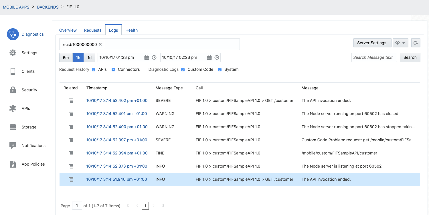

You can access this page by selecting from the logging options in the Related column in the Request History page, or by clicking Logs on the top-level health page.
If you're an administrator, then view the logging data by either drilling down from the Related column in the Errors page or by clicking Logs in Diagnostics. The Logs page lets you view the following logs, either singly or in any combination:
API —These messages describe the REST API calls received by a single backend (if you're a developer), or all backends (if you're administrator). These messages are logged in the API History log. See Taking a Look at Exported Messages.
Connector—These messages describe the outbound calls made by the connectors to SOAP or REST endpoints. These messages help you to troubleshoot problems arising from incorrect connector and endpoint configurations as well as those related to the downstream resource itself (connection timeouts, service unavailable, or other situations that result in 5xx status code messages). See Connector Message Details.
System log—These messages can describe a general problem encountered by AMCe (for example, it can't send notifications to providers like Apple Push Notification Service or Google Cloud Messaging) as well as the cause of the problem (such as an incorrect configuration that prevents a mobile app from sending notifications).

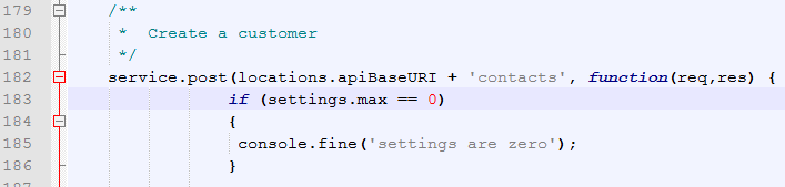

Custom Code—These messages describe the issues logged through the custom code service container. These messages include the ones that are generated by the custom code service itself about the starting and stopping of the Node.js instance and messages created by service developers using the Node.js'
consoleobject.
In addition to the log buttons, you can view the log messages by date using either the presets or the date editor.
You can also apply filters, so that you can view messages by message type, backend, backend version, and API name. You can add filters by selecting from the drop down list, or by entering some criteria in the Filters field. For example, if you're interested in a particular backend, then enter its name in the Filters field.
Tip:
If you don't see any log records, then try selecting different sources of log information or a different time interval.The Logs page lists the log messages by time stamp. Just as you could on the Request History page, you can view the log message by clicking the time stamp.
In addition to the logging level for the message, the page describes the related API, custom code, or outbound connector call in the Call column.
You can retrieve specific error messages by entering terms in the Message Text field, then clicking Search.

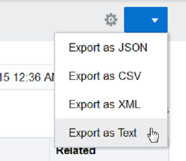

The Logs page displays up to 500 records. If your query returns more than 500 records, click Export
to transfer all of the logging data to a local file that’s formatted in CSV, JSON, text, or XML. The export is restricted to 10,000 log records. See Taking a Look at Exported Messages.

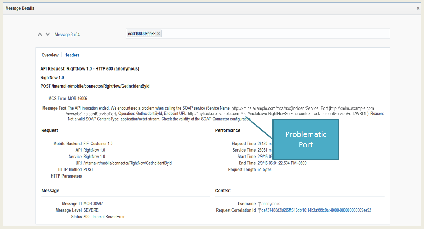

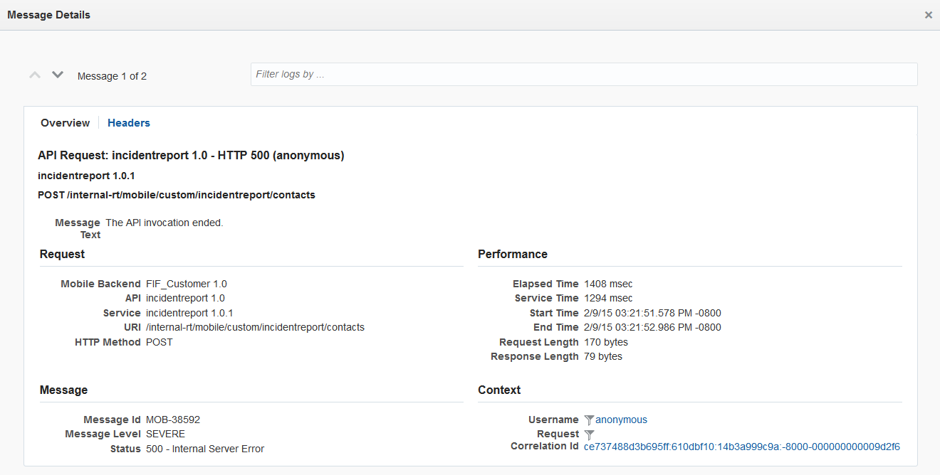

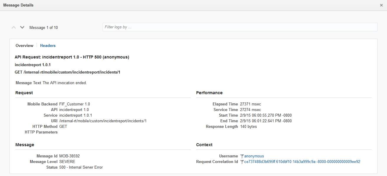

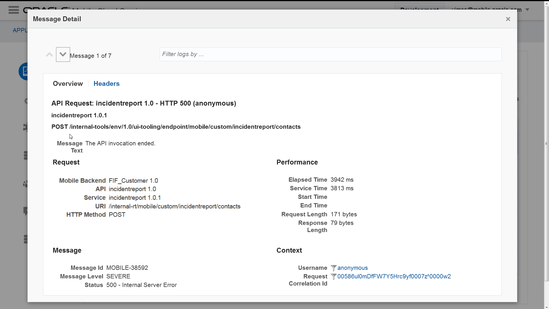

To find out more about a request, review the API history message by clicking the time stamp.
The API history message has two tabs: Overview and Headers. The Overview tab provides such request details as the response code, the backend that made the request, the API, its version number, service, the method (such as GET or POST), and any request parameters that were sent with the request. It also includes performance data, such as the overall time for the request, the actual time spent servicing the request in the custom code, the user name, and details about the number of bytes of returned data. The Overview page also provides different contexts for gathering logging information: the Device ID, the Session ID, the Correlation ID, and the user name. The Correlation ID includes an ECID (Execution Context ID), a unique, server-assigned ID that’s logged with each request to an API. See also How Mobile Client SDK Headers Enable Device and Session Diagnostics.
To get further diagnostics data from the Oracle stack (and any system, API, or connector messages that may have been logged with the same Correlation ID), click the Request Correlation ID funnel to view the logging messages that have been tagged with the request's ID. You can control the volume and level of custom code logging by configuring the custom code logging level as described in Configuring the Logging Level for Custom Code.
Clicking the Headers tab gives you information about request and response headers.
Exporting log files to a local file provides a set of logging data in addition to the information displayed in the Details pages.
As an app developer who's debugging backend code, or as an administrator investigating a sudden increase of 5xx status codes, you can use correlated logging to identify flaws in code or changes in backend services that adversely affect the user experience.
For example, if a syntax error in JavaScript code results in HTTP 500 (internal error) status codes, then an app developer can do the following:
Drill down to the Request History page by clicking HTTP 5xx errors or Request History.
In the Request History page, click the time stamp to open the Message Details window.
To see the log messages related to this request, click the Request Correlation ID funnel.
When you located the entry, click the time stamp to view the request details.

To investigate this error by reviewing the logging data related to this request, as a developer, do the following:
Click HTTP 5xx Errors to open the Request History page.
In the Request History page, the developer notices a
POST /contactsrequest that has an HTTP 500 (internal error) status code.
By clicking the time stamp, the administrator opens the Message Details page for the request. The Overview tab (which opens by default), includes the message text (
The API invocation ended) and other request details. -
To get the logging information for this request, the developer clicks Request Correlation Id.
The log viewer includes an entry for a custom code problem, which is ranked as
SEVERE. -
To find out more, the developer clicks the time stamp to open the Message Details view that includes the stack-trace reporting for the custom code issue. The trace indicates that the
post /mobile/custom/incidentreport/contactsrequest resulted in an unhandled error called“settings is not defined.”Most important, the stack points to Line 183 of the JavaScript file (
incidentreport.js) as the source for the unhandled error.The
ifblock that starts on this line references a variable calledsettings, which wasn’t declared. -
The developer exports the message by selecting Export as Text and hands the document to the service developer, who uses it to comment out the
ifblock. The service developer then refreshes the implementation (.impl) file for the custom code API with the updatedincidentreport.jsfile. Soon thereafter, the calls return anHTTP 200 (OK)status code.Tip:

Use Case: Using Correlation to Diagnose Connector Issues
Like app developers, administrators also use correlation. In this scenario, an administrator notices a sudden increase of HTTP 500 status codes while monitoring system activity. The health status for the environment has changed to adverse (red).
To solve this problem (and prevent degradation to the user experience), as the administrator, do the following:
Click HTTP 5xx Errors on the Diagnostics page to open the Request History page.
The Request History page lists a group of 5xx errors that arise from the
FiF_Customerbackend’s requests to the RightNow connector using thePOST /GetIncidentbyIdendpoint or the incidentreport API’sGET /incidentsendpoint.
Description of the illustration request_history_environment_external.png -
Drill down to the message details for one of the
GET /incidents/{id}calls by clicking the time stamp. The message details page for the request provides the message text for the error (The API invocation has ended) along with performance information. -
To find out more, the administrator clicks the Request Correlation Id to view the logging data.
Because the APIs are correlated to the connector calls, the Logs page shows SEVERE messages for both the incidentreport API and the RightNow Connector.
Open the Message Detail page for the RightNow connector by clicking the time stamp.

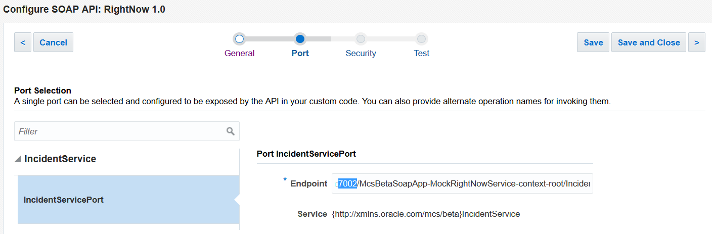

The message details page identifies the error as a problem with the SOAP service (per error message MOBILE 16006) and provides the service name (incidentService) and port (7002) along with a tip:Check the validity of the SOAP connector configuration. -
Confer with the RightNow service provider. After finding out that the service’s port number is now 7001, the administrator updates the RightNow connectors Endpoint with the correct port number.
Test the
GET /Incidents/{id}endpoint for the incidentreport API.After seeing the200 (OK)response, the administrator confirms that the connector configuration is now correct.
