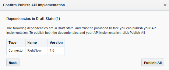

After you have an API implementation in a Draft state that’s configured and tested, you’re ready to publish it. API implementations go through the same lifecycle phases as APIs, in addition to being published, new versions can be created, existing versions can be updated, and obsolete implementations can be moved to the trash.
Remember that after an API implementation is published, it can’t be changed. If you’re still configuring and testing the implementation, keep it in a Draft state until it’s ready for the next phase of the lifecycle.

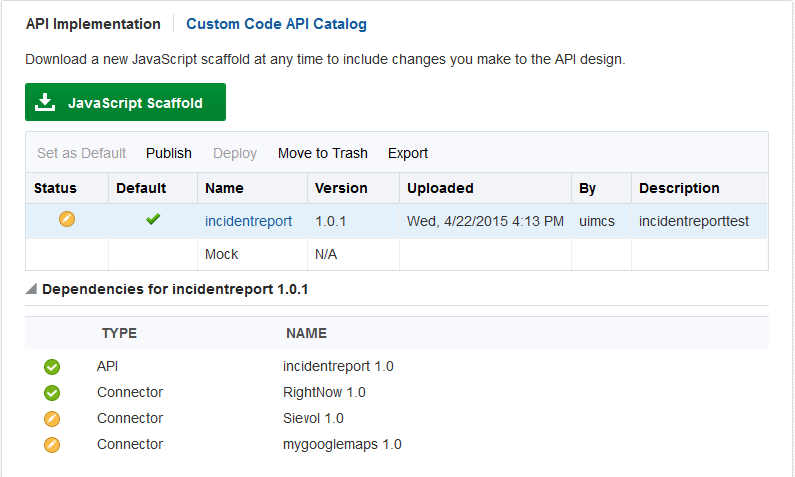

Publishing an API Implementation

Implementation versions are maintained independently of API versions. When you publish an API, the implementation isn’t published automatically.
When you upload a new version of an implementation, it becomes the default version (active implementation) for that API. You can change the default version in the API’s Implementations page.
The custom API’s
Routing_BindApiToImpl
policy defines the association between an API version and the implementation version.
