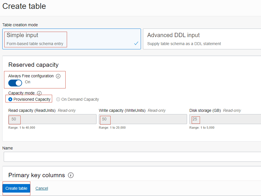

Click Create Table.

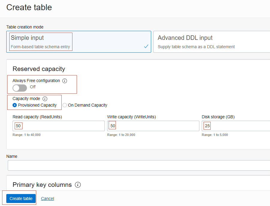

In the Create Table dialog, select Simple input for Table Creation Mode.
Under Reserved Capacity, you have the option to enable Always Free configuration or to configure Capacity mode. Always Free configuration is currently available only in the Phoenix region.
Always Free Configuration (Available only in the Phoenix region):
Enable the toggle button to create an Always Free NoSQL table. Disabling the toggle button creates a regular NoSQL table. You can create up to three Always Free NoSQL tables in the tenancy. If you have three Always Free NoSQL tables in the tenancy, the toggle button to create an Always Free SQL table is disabled.
If you enable the toggle button to create an Always Free NoSQL table, the Read capacity, Write capacity, and Disk storage fields are assigned default values. The Capacity mode becomes Provisioned Capacity. These values cannot be changed.
To learn more about the details, features, and restrictions of tables created with the Always Free Configuration option, you can see Always Free Service.
If you want to create a regular table, then disable the toggle button. You will be able to enter the appropriate capacity values for the table.
Read Capacity (ReadUnits): Enter the number of read units. See Estimating Capacity to learn about read units.
Write Capacity (WriteUnits): Enter the number of write units. See Estimating Capacity to learn about write units.
Disk Storage (GB): Specify the disk space in gigabytes (GB) to be used by the table. See Estimating Capacity to learn about storage capacity.

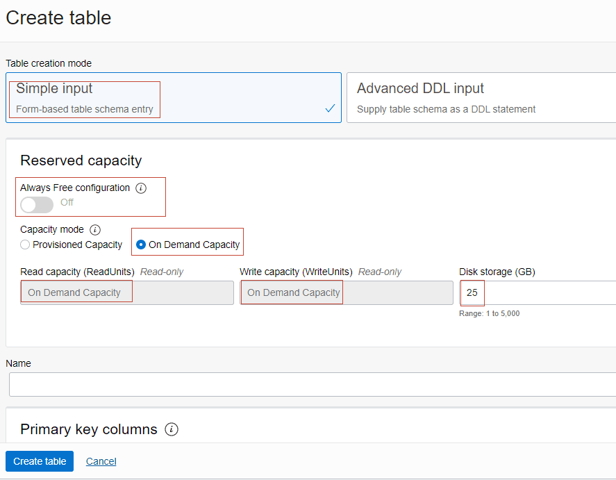

Capacity mode
You can specify the option for Capacity mode as Provisioned Capacity orOn Demand Capacity. Provisioned Capacity and On Demand Capacity modes are mutually exclusive options. If you enable On Demand Capacity for a table, you don’t need to specify the read/write capacity of the table. You are charged for the actual read and write units usage, not the provisioned usage.
Enabling On Demand Capacity for a table is a good option if any of the following are true:
You create new tables with unknown workloads.
You have unpredictable application traffic.
You prefer the ease of paying for only what you use.
Limitations of enabling On Demand Capacity for a table:
On Demand Capacity limits the capacity of the table to 5,000 writes and 10,000 reads.
The number of tables with On Demand Capacity per tenant is limited to 3.
You pay more per unit for On Demand Capacity table units than provisioned table units.
Selecting On Demand Capacity disables Always Free Configuration. The Read Capacity and Write Capacity input boxes become read-only and show the text On Demand Capacity. The On Demand Capacity tables will show On Demand Capacity in their read and write capacity columns. If Capacity mode is On Demand Capacity then the Always Free control is disabled. Specify the Disk storage (GB) value.

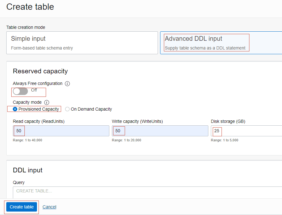

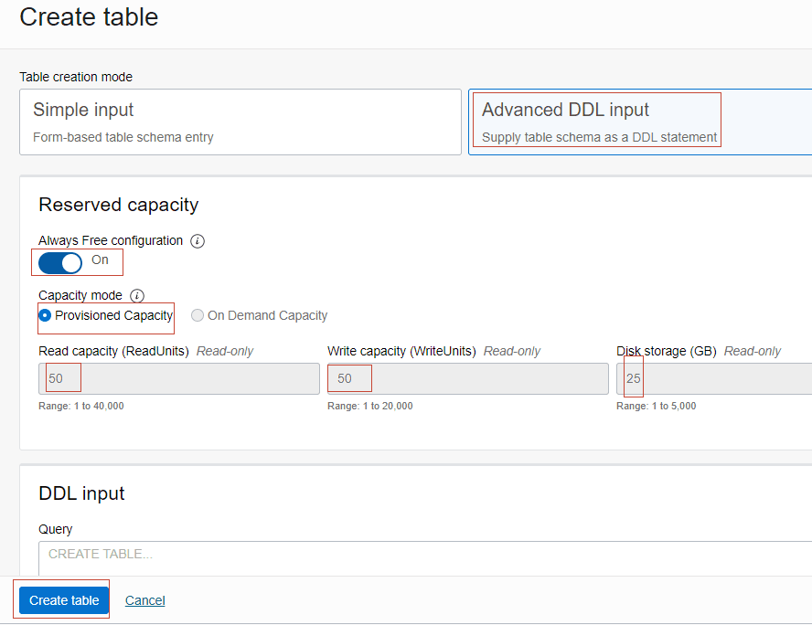

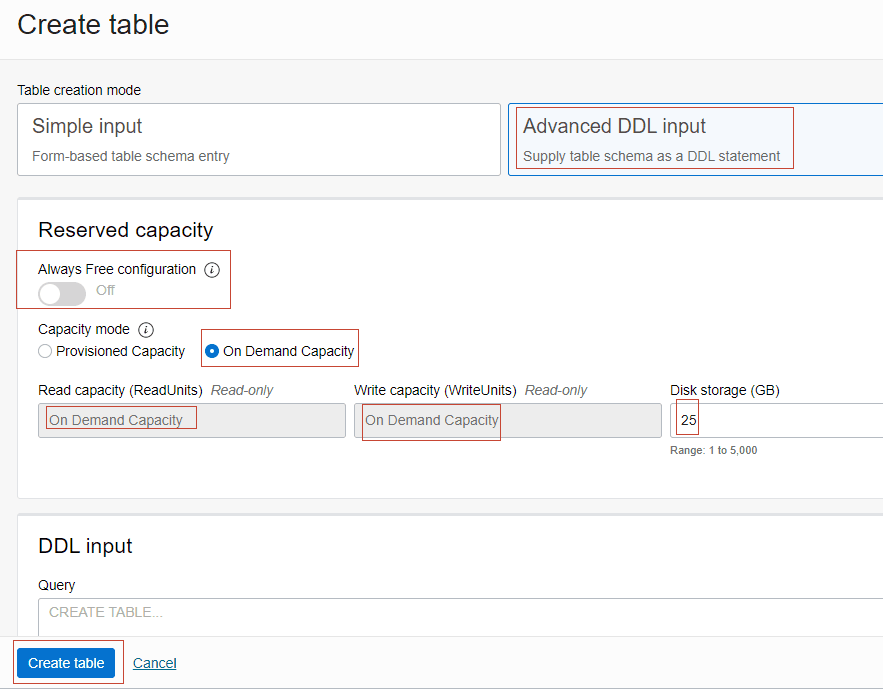

Capacity mode
In the DDL input section, enter the create table DDL statement for Query. You may get an error that your statement is Incomplete or faulty. See Debugging SQL statement errors in the OCI console to learn about possible errors in the OCI console and how to fix them.
You can use Advanced DDL mode to create tables with Identity columns, UUIDs, and JSON collection tables. Provide the table DDL in the DDL input. See Developers Guide for examples on create table statement.

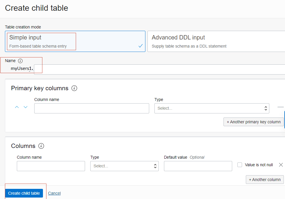

You can select Simple input method or Advanced DDL input method to create the child table.
Specify a name for the child table. This is automatically prefixed with the name of the parent table followed by a dot. Specify the list of columns and primary key columns.
The Set as shard key checkbox is not shown while creating a child table, as the child tables inherit their shard key from their top-level parent table.

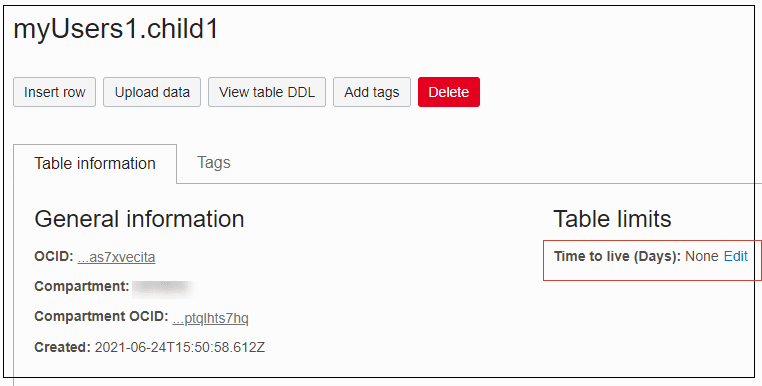

Viewing the details of a child table
You can view the details of a child table after it is created.
