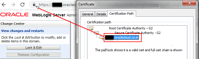

You can replace the identity and trust of Oracle SOA Suite with custom identity and custom trust and register the Oracle SOA Suite server with digital certificates procured from public certificate authorities like digicert or any other third party authority.
As a prerequisite, register Oracle SOA Suite domain with the public DNS for CA verification. For the documentation purposes, the public IP of the Oracle SOA Suite domain is registered with mydomain.com and takes the CA signed certificates from mydomain.
The Enterprise Manager (EM) console needs to be accessible using the public domain name.

  2. Test access to the Enterprise Manager (EM) Console and the WebLogic Server Console through the domain name registered.

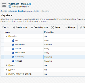

  1. Log in to the Enterprise Manager (EM) Console and access the Keystores page by opening WebLogic domain > Security > Keystore.
  2. Under the system stripe, click Create Keystore.
  3. Provide the following details for custom identity:
    1. Keystore Name: custIdentity
    2. Protection: select the Password option
    3. Keystore Password: enter the password
    4. Confirm Password: reenter the password

  6. Click Manage on the custIdentity keystore name, click Generate Keypair to create a new key pair, and provide the following details:
    1. Alias Name: custIdentity
    2. Common Name: common name; for example, soacs.mydomain.com (domain name registered with public DNS)
    3. Organizational Unit: name of the organizational unit
    4. Organization: organization name
    5. Enter City, State, and Country names
    6. Key Type: RSA
    7. Key Size: 2048
  7. Click OK to generate the key pair.

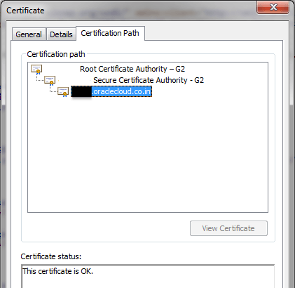

  4. Double-click the certificate chain for the root and intermediate certificates. You can see the full chain when you click on certification path.
  5. Extract the root and intermediate certificates individually by going to the certification path, select the certificate to be extracted (root or intermediate), and click View Certificate.
  6. In the View Certificates popup, select the Details tab and click Copy to File.
  7. In the Certificate Export wizard, click Next, select Base 64 encoded X.509 (CER), then click Next. Export the certificate.
  8. Name the exported certificate as root and intermediate certificates respectively.

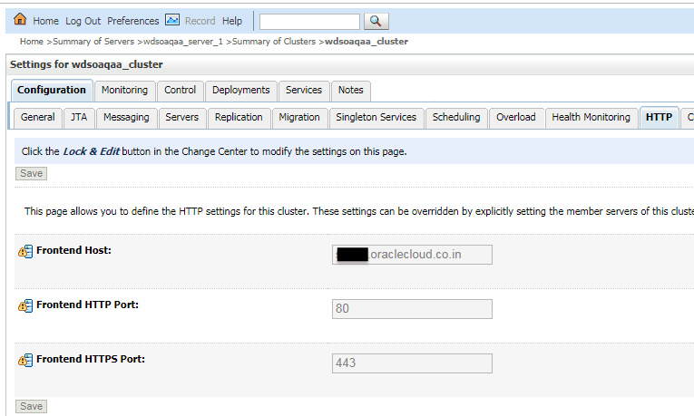

  1. Log in to the WebLogic Server Administration Console.
  2. Navigate to Servers > Admin Server > Configurations > Keystores tab.
  3. Change the Keystores to Custom Identity and Custom Trust and Save.
  4. Provide the values for Custom Identity:
    • Custom Identity Keystore: kss://system/custidentity
    • Custom Identity KeyStore Type: KSS
    • Custom Identity PassPhrase: enter the password given while creating the custIdentity keystore
    • Confirm Custom Identity PassPhrase: reenter the password
  5. Provide the values for Custom Trust:
    • Custom Trust Keystore: kss://system/custTrust
    • Custom Trust KeyStore Type: KSS
    • Custom Trust PassPhrase: enter the password given while creating the custIdentity keystore
    • Confirm Custom Trust PassPhrase: reenter the password
  6. Click Save and then activate changes.

  12. To update the Frontend Host Port, update the host and port in the WebLogic Server Console to reflect the domain name and ports:
    1. In the WebLogic Server Console, navigate to Environments > Clusters > Cluster Name > HTTP tab.
    2. Update the Frontend Host as the domain name.
    3. Update the Frontend HTTP Port, default is port 80.
    4. Update the Frontend HTTPS Port, default is port 443.

  1. Deploy a HelloWorld composite and verify that the client endpoint URL can be opened on https host and port.
    The valid certificate chain is present on the client endpoint URL:
    Description of verify_certificate.png follows
  2. To invoke the client end point from any other composite, import all the certificates (signed server, intermediate, and root) present in the WSDL into the truststore of the server from where the parent composite is deployed.
