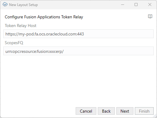

    The wizard displays a screen for entering token relay properties. This image shows the screen with sample values in the screen's fields.
    You can also access this screen for an existing catalog from the Advanced page of the Business Object Catalog Editor. To open this screen, select Oracle Fusion Applications Token Relay from the Authentication list, then click Edit Authentication Flow Properties. See Set an Authentication Method for a REST Service.
  3. If the Fusion Applications token relay service is located on a different host than the REST service, type the token relay host in the Token Relay Host field.
    The host should use this format: <protocol>://<host>:<port>. For example:
    https://my-pod.fa.ocs.oraclecloud.com:443
    Do not include the path to the Fusion Applications token relay service.
  4. If you want to include a scopesfq query parameter, type it in the ScopesFQ field.
    If you include a value here, the add-in URL-encodes this value and adds it as the scopesfq query parameter value when calling the token relay service.
  5. Click Next to proceed through the New Layout Setup wizard.
The sample values in the image results in this URL (with URL encoding omitted for readability):
https://my-pod.fa.ocs.oraclecloud.com:443/fscmRestApi/tokenrelay?scopesfq=urn:opc:resource:fusion:xxx:erp/
