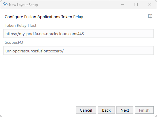

    The wizard displays a screen for entering token relay properties. This image shows the screen with sample values in the screen's fields.
    You can also access this screen for an existing catalog from the Advanced page of the Business Object Catalog Editor. To open this screen, select Oracle Fusion Applications Token Relay from the Authentication list, then click Edit Authentication Flow Properties. See Set an Authentication Method for a REST Service.
  3. If the Fusion Applications token relay service is located on a different host than the REST service, type the token relay host in the Token Relay Host field.
    The host should use this format: <protocol>://<host>:<port>. For example:
    https://my-pod.fa.ocs.oraclecloud.com:443
    Do not include the path to the Fusion Applications token relay service.
  4. If you want to include a scopesfq query parameter, type it in the ScopesFQ field.
    If you include a value here, the add-in URL-encodes this value and adds it as the scopesfq query parameter value when calling the token relay service.
  5. Click Next to proceed through the New Layout Setup wizard.
The sample values in the image results in this URL (with URL encoding omitted for readability):
https://my-pod.fa.ocs.oraclecloud.com:443/fscmRestApi/tokenrelay?scopesfq=urn:opc:resource:fusion:xxx:erp/

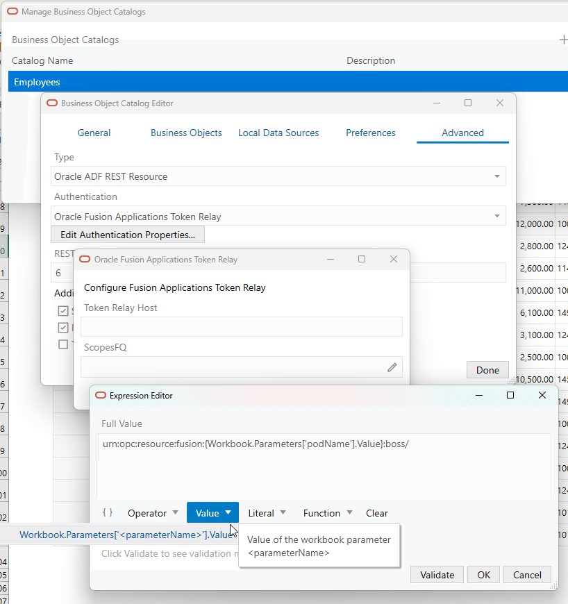

Use Workbook Parameters for ScopesFQ in Fusion Application Token Relay Authentication
You can add expressions that reference workbook parameters in the ScopesFQ property of Oracle Fusion Applications Token Relay Authentication.
For example, you might rely on a workbook parameter in your integrated workbook using the podName value. At runtime, during authentication, this workbook parameter value (podName) is used in place of the expression, yielding the URL for authentication: ....../tokenrelay?scopesfq=urn:opc:resource:fusion:orclpod:boss/
ScopesFQ supports a workbook parameter expression: {Workbook.Parameters['<parameterName>'].Value}. See Workbook Parameters in Expressions and Use Expressions in an Integrated Workbook. For information about embedding workbook parameters in a workbook, see Embedding Workbook Parameters in a Workbook.
To use a workbook parameter for ScopesFQ in the Oracle Fusion Applications Token Relay:
  1. Click Manage Catalogs.
  2. In the Manage Business Object Catalogs window, select your catalog and click the Edit Business Object Catalog (Edit Business Object Catalog) icon.
  3. From the Business Object Catalog Editor, click Advanced and, in the Advanced tab, select the Edit Authentication Properties
  4. In the Oracle Fusion Applications Token Relay window, click the Edit icon (Edit icon in the ScopesFQ field) in the ScopesFQ field to open the Expression Editor.
  5. In the Expression Editor, from the Value dropdown list choose "{Workbook.Parameters['<parameterName>'].Value}" to embed a workbook parameter value.
  6. Replace <parameterName> with the name of your workbook parameter and click OK.
    Expression Editor for ScopesFQ Property
    If the Fusion Applications token relay service is located on the same host as your REST services, then you can leave the Token Relay Host field blank, and the add-in uses the catalog's host instead.
