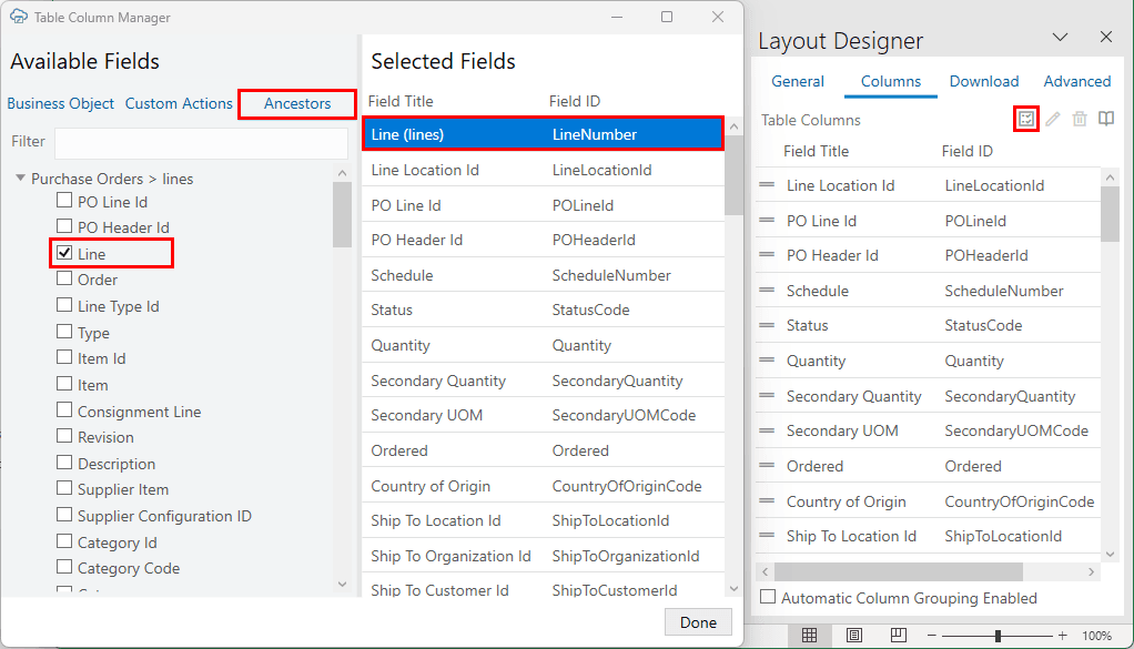

To add an ancestor column to your layout:
Open the Table Column Manager from the Layout Designer.
Click the Ancestors tab from the Available Fields pane.
Available ancestor columns are grouped by business object. In this image, fields for the lines business object are shown under Purchase Orders > lines.
Expand the list if necessary, then select the parent field you want to add to your layout.
Note: To add a parent field before an existing column in the table, select the existing column in the Selected Fields list, then select the parent field check box. For example, to display a parent field first in the table layout right after the Status column, select the first column.
Click Done to close the Table Column Manager.
Oracle Visual Builder Add-in for Excel redraws the table in the layout to include the parent column.
If column grouping is not enabled, the table header for the parent column uses the format “<field title> (<business object title>)” such as “Line Number (lines)”. If it is enabled, the parent column’s field title appears under a group header for the parent business object. See Group Columns in a Table.
