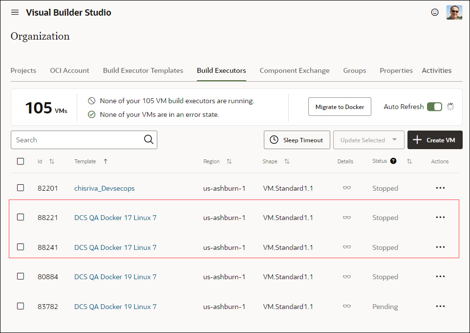

You add and manage VM executors from the Build Executors tab on the Organization page:
  1. In the left navigator, click Organization Organization.
  2. Click the Build Executors tab.
This table describes the actions you can perform to manage VM executors.

Find VM executors of an executor template In the search box, enter the executor template’s name.
Sort VM executors Click the arrow icon in the column’s header to sort VM executors. For example, to sort VM executors by their state, click the arrow icon in the Status column’s header.

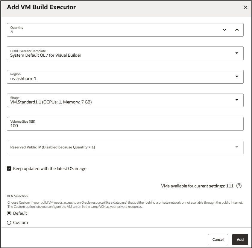

  2. Click + Create VM.
  3. In the Add VM Build Executor dialog box, in Quantity, specify the number of VM executors you want to create.
    To minimize build execution delays, set the number to the number of jobs that you expect to run in parallel using the template you'll specify in Build Executor Template. If you're not sure, start with one VM executor. You can add more VM executors later, based on your actual usage.
  4. In Build Executor Template, select the executor template.
  5. In Region, select the region that's closer to you geographically.
    The drop-down list displays regions your OCI account is subscribed to.
  6. In Shape, select the VM executor's shape.
    For example:
    Description of add-vmbuildxecutor-withlatestos1.png follows
    Click the question mark icon Help iconto see how the number of available VMs was calculated for the current settings. Here's an example of what you might see:
    Description of add-vm-executor-stats-2.png follows
    The display shows the realtime statistics that were used to make this calculation, using your settings. As you change your settings, new statistics are computed and displayed. See What Determines How Many VMs I Can Create? for more information about how the calculations are made.
    If the required number of Compute VM instances aren't available, choose another shape.
  7. Enter the Volume Size (between 50 GB and 500 GB) you want to use for each build this VM executor builds. The default is 100 MB. Larger volumes give more space per VM. While this is great for heavy workloads, the drawback is you won't be able to create as many VMs.
  8. Optionally, select Keep updated with the latest OS image.
    If you select this option, VB Studio checks nightly for new OS versions from OCI (usually, OCI releases about one new OS version each month) and automatically updates any affected VMs. This keeps your VM executors up to date without waiting for the quarterly updates.
    If a build is already running when the update is to start, VB Studio lets that build finish first, then starts the update. If a build is scheduled to start during the update, VB Studio runs the update first and then starts the build right after.
    Note that these updates might temporarily delay any scheduled builds, but they’ll start as soon as the update is complete.
  9. Select the Reserved Public IP that you want to add to the VM executor. You can add one Reserved Public IP to each VM executor.
    An allow listing for your VM executor is possible only if you specify an OCI account by assigning a Reserved Public IP to a build executor. The Reserved Public IP must be defined in the compartment of the specified OCI account.
  10. In VCN Selection, select Default, and then click Add.
The new VM executor is in the Pending state until you manually start it or trigger a job's build that references the associated executor template.

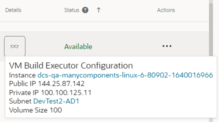

Get the name and IP addresses of a VM executor’s VCN subnet.
  1. In the VM executor's Details column, click Show machine details Details.
  2. Note the VCN subnet's name.
The VM executor's subnet name is displayed only if it's in the Available state. If the VM executor is in the Stopped or the Pending state, click Actions and select Start to start the VM executor
