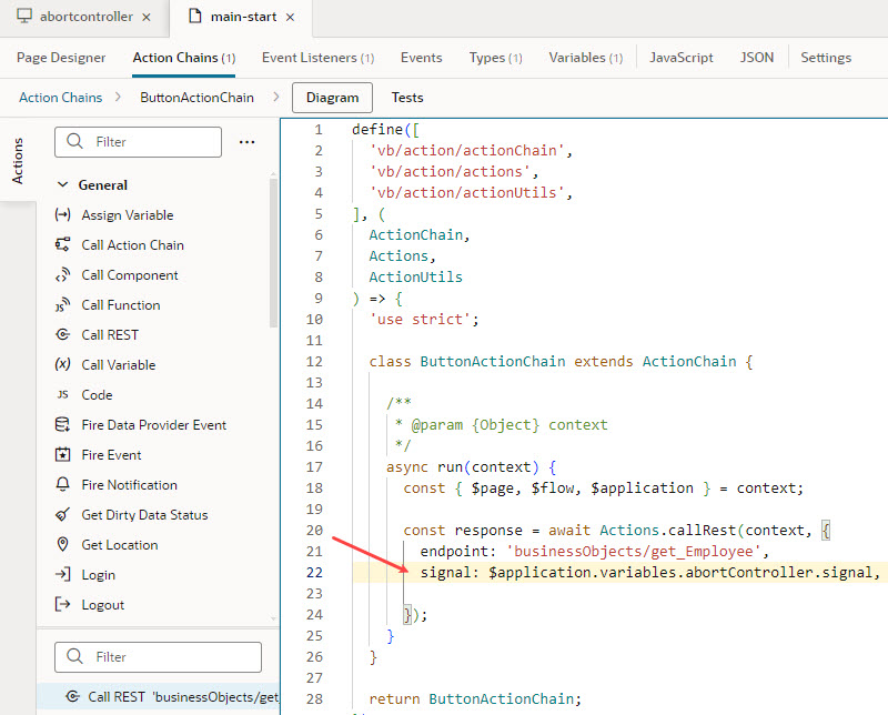

  4. Associate the AbortController with the REST call you want to abort. You do this by attaching the AbortSignal of an AbortController instance to the REST request via the signal option. For example, to abort the Get/Employee/{Employee_Id} endpoint request, you attach the AbortSignal to the Call REST action in the action chain underlying the button component (which is ButtonActionChain in our example).
    1. Open the action chain that uses the Call REST action in the Action Chains editor. Because our example assumes a Call REST button on a page, this Call REST action exists in the ButtonActionChain action chain defined at the page level.
    2. Click Code to switch to code view.
    3. Locate the code snippet for the particular Call REST action and add this line after the endpoint constructor:
      signal: $application.variables.abortController.signal,
      In this example, the AbortSignal is accessed via $application.variables.abortController.signal and attached to the get_Employee REST request:
