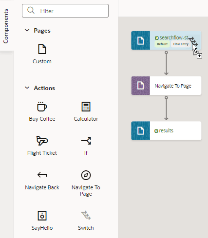

  1. Select an application’s flow to open it the Flow Diagram view ( Flow Diagram view ).
  2. Drag and drop an action (built-in or custom) under Actions in the Components palette and drop it onto a page in the diagram.

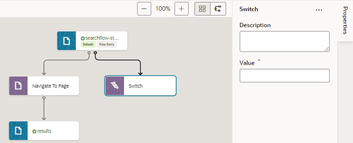

  3. When prompted to select an event listener, select Bind an event listener later. If you want to bind an action chain to an existing event listener, you’ll need to first surface it in the Flow Diagram. See Bind an Action Chain in the Flow Diagram to an Existing Event Listener.
    A new action chain is created with your action as the root. Use the action’s Properties pane to suitably configure your action’s properties. The properties that display are typical for built-in actions. For example, here’s what you’ll see for a Switch action:
    Description of the illustration diagramview-flow-action-configureproperties-appui.png

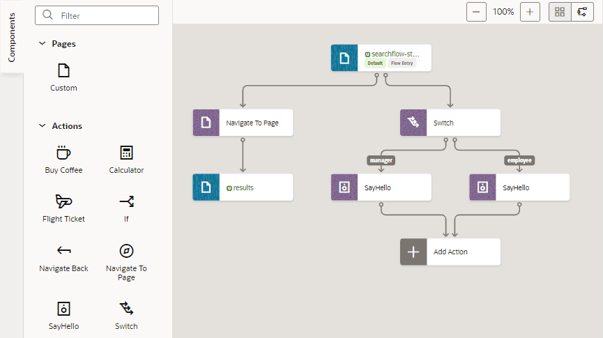

  4. If your action involves additional steps, drag and drop additional actions as needed.
    Say you want to call a custom Say Hello action in the Switch action to display an employee-specific message, you would drag the Say Hello action onto the switch action to add multiple cases:
    Description of the illustration diagramview-flow-dragndropaction-substeps-appui.png

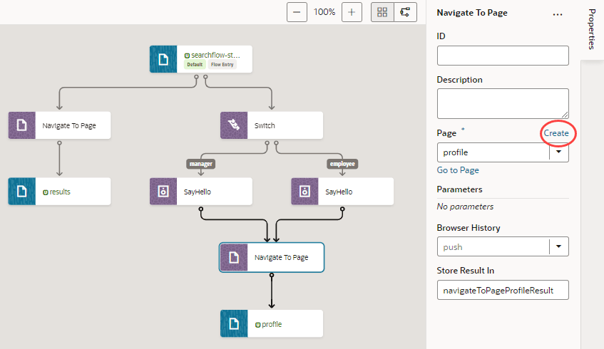

    The cases you add for the Switch action show as labels, as do outcomes of decision nodes for an If action. The first action you drop onto an If action is considered the true outcome and the second is considered the false outcome. When the If action has both true and false outcomes or a Switch action has more than one outcome, a placeholder Add Action node appears (as shown in the image above), so you can specify the action after the branches join (Navigate To Page as shown here):

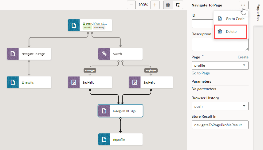

    If you want to delete an action, click Menu Menu icon in the action’s properties and click Delete.
