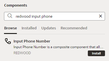

    3. Select the Browse tab and search for the component you want to use. For example, you might use "redwood input phone" to look for the Input Phone Number component:
      You can double-click the component to open it in the canvas area and learn more about it.
    4. Click Install (or Install Component in the canvas).
      Once you install a component, it will become available to you in your page’s Components palette. Simply filter to find the component.
