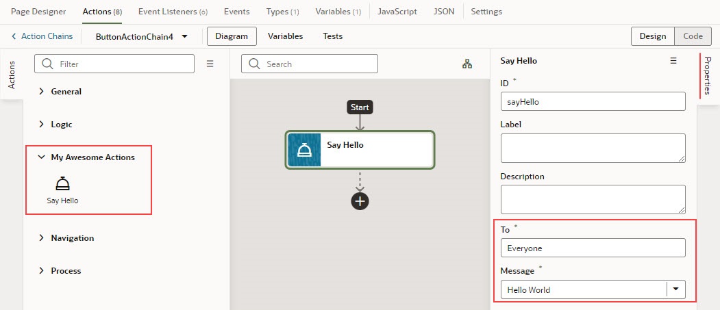

The Action Chains editor uses the metadata to add the custom action to the Actions palette and to display its parameters in the Properties pane:

The values you enter for the action’s input parameters, To and Message, in the Properties pane, are passed to the perform() method using the input parameter, parameters.
