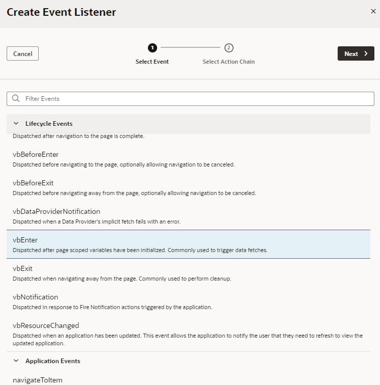

  1. Open an artifact’s Event Listeners tab, then click + Event Listener.
  2. In the Create Event Listener wizard, select the event you want to trigger an action chain. Depending on where you’re creating the listener, your list might include page events, flow events, and application events, in addition to lifecycle events.
  3. Click Next.

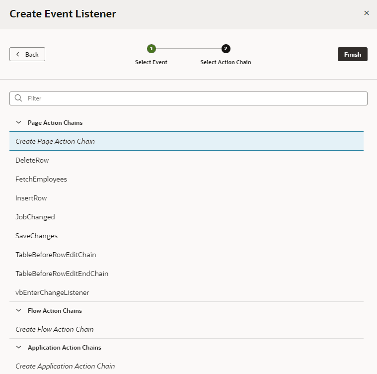

  4. Select the action chain you want to trigger, or create a new action chain which you can edit later.
    While an event listener can trigger multiple action chains, you can add only one action chain at a time in the wizard.
  5. Click Finish.

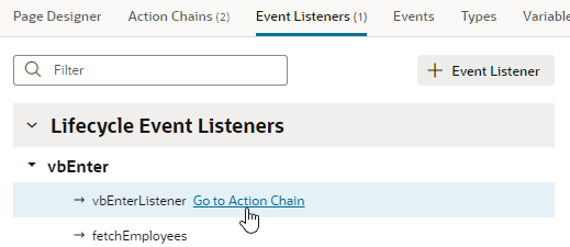

If you chose to create a new action chain, look for the associated event listener, typically prefixed with the event you chose. For example, if you selected vbEnter as the event, a new event listener called vbEnterListener is created under Event Listeners.

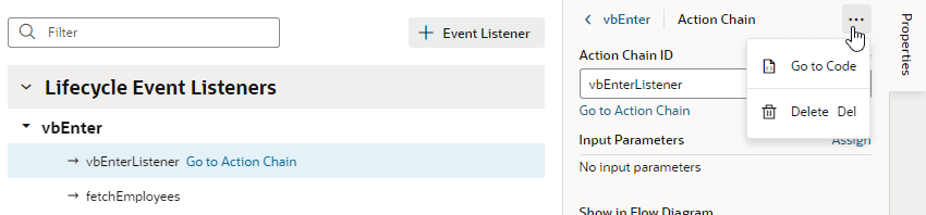

To edit an action chain associated with an event listener, move your cursor over the action chain (or select it), then click Go to Action Chain to open the action chain in the Action Chains editor.

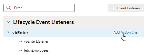

You can add additional action chains to an event listener any time you want. Simply move your cursor over the event name (or select it), then click Add Action Chain to relaunch the Create Event Listener wizard.
If you want to delete an event listener, or remove an action chain triggered by an event listener, select it and click Delete from the Actions menu in the Properties pane. Deleting an action chain in the Event Listeners tab means it will no longer be triggered by the listener, but it won’t delete the actual action chain.
