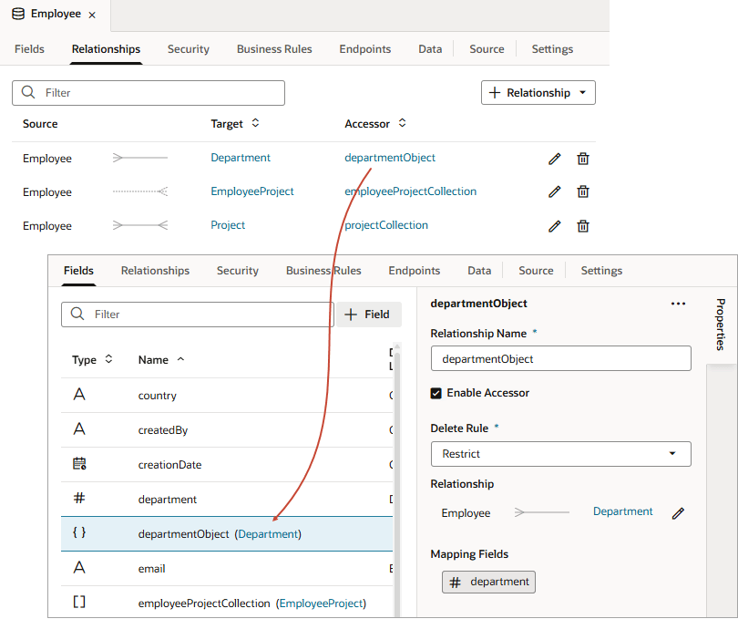

By default, the accessor from the source object to the target object is enabled (
departmentObjectfor Employee, in our example). This means that if you were to drag the Employee object onto a page to create a table, you’ll be able to fetch the employee’s details, including the department they work in. But if you want to access Department from Employee (say, to fetch employees in each department), you must enable the accessor for the target object (employeeCollectionfor Department, in our example). -

The new relationship is displayed on the Relationships tab, along with the accessor that lets you access the business object at the other end of the relationship. Clicking the accessor name will take you to the Fields tab, where you’ll see the accessor listed along with other fields.
