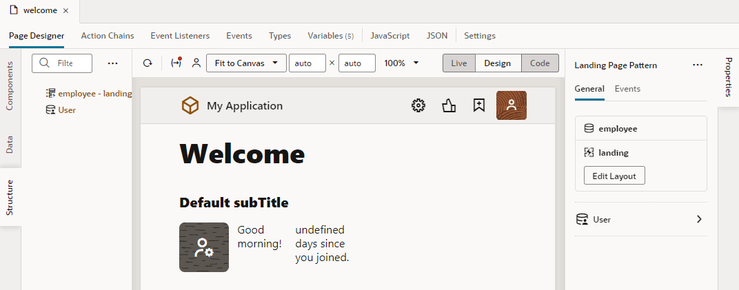

If your fragment’s properties were customized, what you see on the page’s Properties pane will be different. Instead of the standard page-level properties, you’ll see fragment properties that the fragment author chose to highlight. Here’s an example where the author has customized the fragment’s properties, so that some input parameters show in a separate section when the page is selected:
(To view the page’s Properties pane, make sure no component or element is selected on the page. If you need to, simply click an empty area on the page.)
The page’s Structure view also changes, with the fragment considered the root element, instead of the page.
