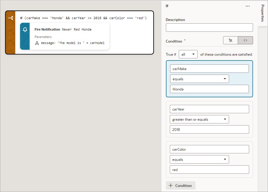

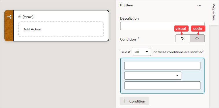

  2. With the If block selected on the canvas, use either the visual condition builder or the code condition builder to create the condition. To visually create the condition, click the first field in the blue box and select the variable to compare against a value or another variable. Select the comparison operator using the second filed, and enter the value or variable to compare against in the third field.
  3. To add another condition, click the + Condition button and create the condition as explained in the previous step.
  4. To reorder, delete, or add a condition before or after an existing condition, right-click the condition to bring up its context menu.
  5. To combine the conditions with an AND operator, select all from the True if list. To combine the conditions with an OR operator, select any from the list.

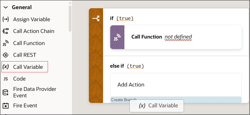

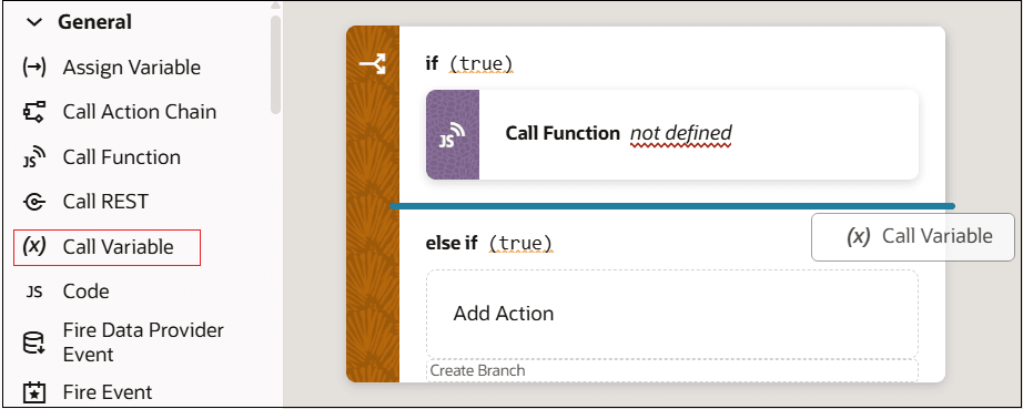

  7. To add an Else or Else If condition, you have a few options:
    • To add a block with a specific action, from the Action palette, drag an action onto the Create Branch drop area (for the last node) or onto the Create Branch drop line (if it’s not the last node).

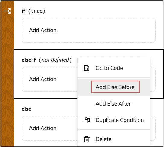

    • To add an empty block at a specific position, right-click an Else or Else-If block and then:
      • Click Add Else Before to get an Else-If block above.
      • Click Add Else After to get an Else block if there’s nothing after, or an Else-If block if other blocks already follow.
