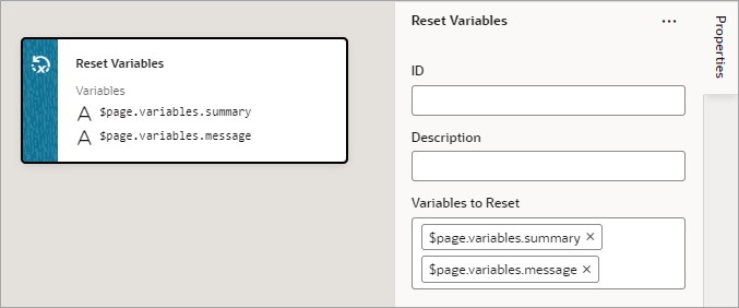

Add a Reset Variables Action
You add a Reset Variables action to reset variables to their default values, as specified in the variable definitions.
For API information about this action, see Reset Variables in the Oracle Visual Builder Page Model Reference.
To use a Reset Variables action:
  1. Add the action in one of three ways, as explained at the end of Built-In Actions.
  2. Update the ID field in the Properties pane to make the action more identifiable.
  3. Click the Variables to Reset box to select the variables that you want to reset. You can also start to type the variable’s name in the box and select it when it appears.
