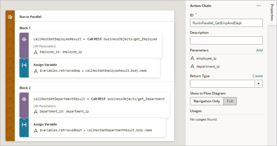

  2. Drop the actions to run for each block in the Add Actions area of the Run in Parallel action. For example, you could make two REST calls and assignments in parallel:

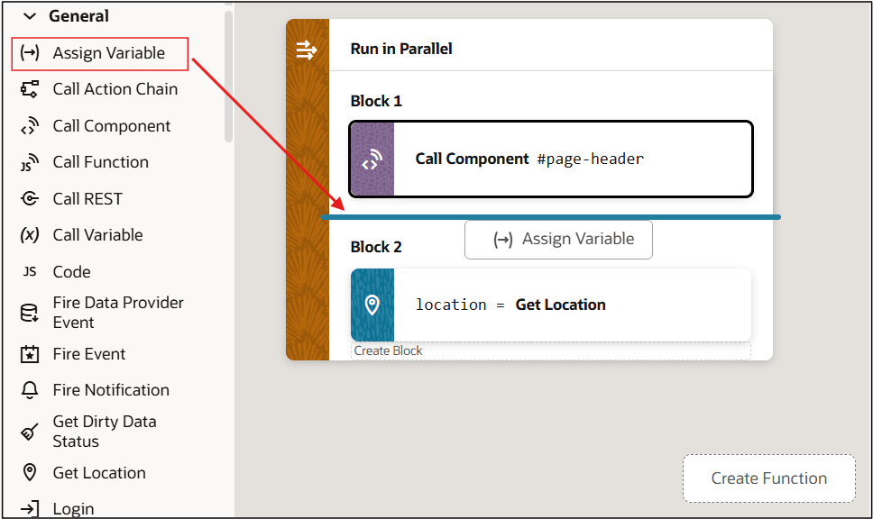

  3. To add another block of code to run in parallel, you have a few options:
    • To add an empty block at the bottom, right-click the Run in Parallel node and click Add Block.
    • To add an empty block at a specific position, right-click a block and click Add Block Before or Add Block After.

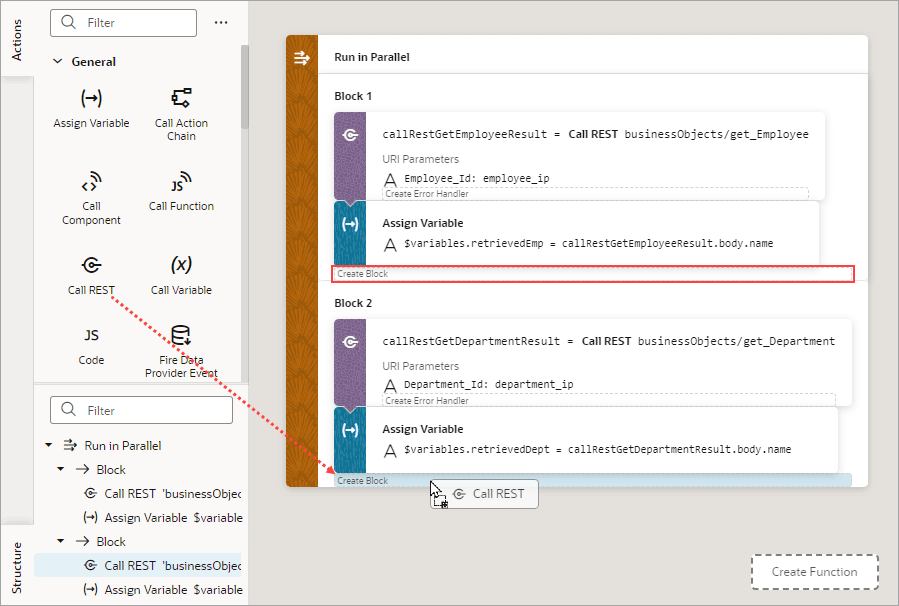

    • To add a block with a specific action, from the Action palette, drag an action onto the Create Block drop area (for the last node) or onto the Create Block drop line (if it’s not the last node).

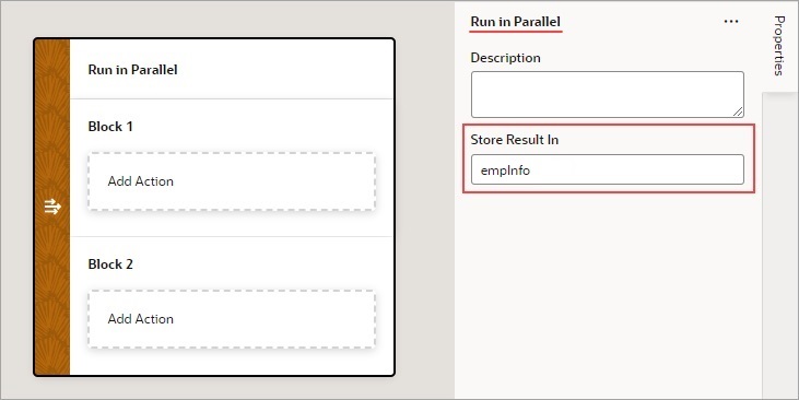

  2. For the Store Result In property, provide a name for the array that will hold the result from each block. The first block’s result is stored at index 0, the second block’s result is stored at index 1, and so on.

    • To add a block with a specific action, from the Action palette, drag an action onto the Create Branch area (for the last node) or onto the Create Function drop line (if it’s not the last node).

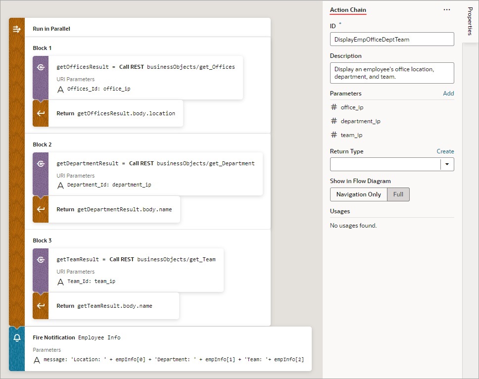

  5. Drop a Return action at the end of each block to return its result in the array that was named using the action’s Store Result In property:
    An array is returned by the Run in Parallel action (empInfo for this example, set in step 2): the first element contains the first block’s result, the second contains the second block’s result, and the third contains the third block’s result.
