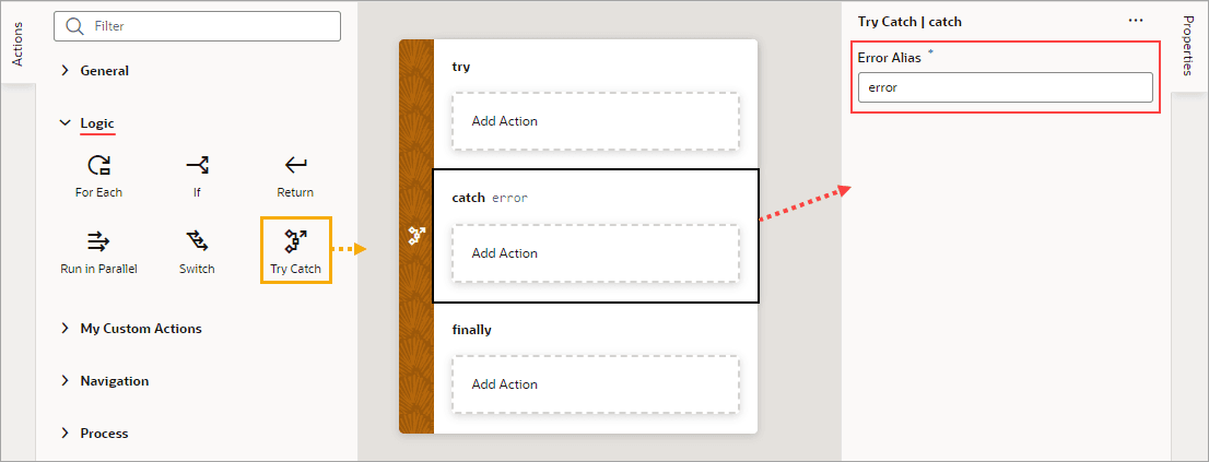

Add the action in one of three ways, as explained at the end of Built-In Actions.
To change the alias for the error object, which has the
nameandmessageproperties, select the Catch block on the canvas and change the alias in the Properties pane:

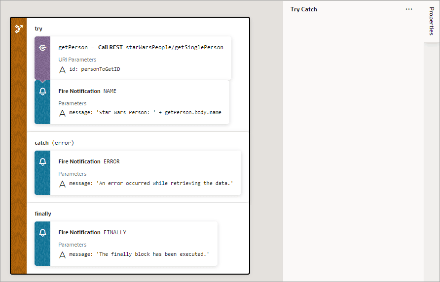

To add an action to a Try-Catch block, select the block and double-click the action in the Actions palette, or drag an action from the Action’s palette onto the desired block:

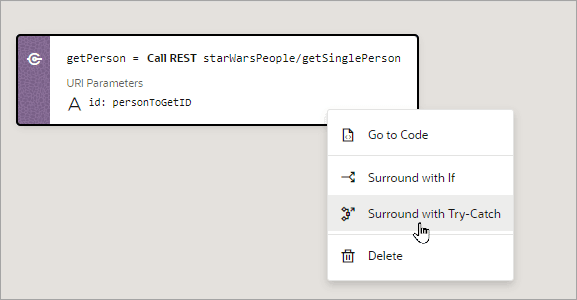

You can also surround an action with a Try-Catch action by right-clicking it and selecting Surround with Try-Catch:

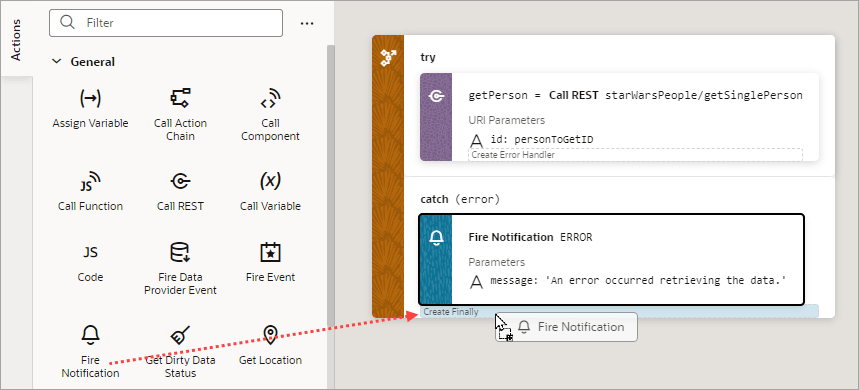

To add a Finally block with a specific action, drag the action that you want to the Try-Catch action and drop it into the Create Finally area that appears:

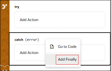

To add an empty Finally block, right-click the try or catch block and click Add Finally.
