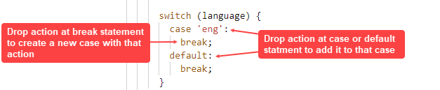

For the Switch and If actions, you can add actions to a clause, or create a new one, depending on where you drop the action:
Switch:
