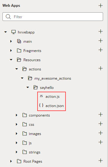

my_awesome_actions/sayhello, wheremy_awesome_actionsis the name of your group folder, andsayhellois the name of your action.The two newly created
action.jsandaction.jsontemplates are stored under the pathresources/actions/<action-group>/<action-name>/, as shown here:

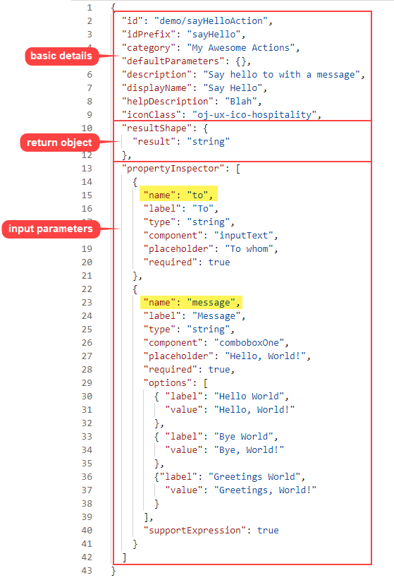

Here’s an example of the action.json file for the sample sayHello custom action, with a breakdown of its parts:
The first set of properties provide the basic details about the custom action.
The
resultShapeproperty provides the definition for the object returned by the action’s implementation method, which can be used as input for another action when creating an action chain. For instance, the string returned by this action can be an input for an action that writes the string to a log file. -
The
propertyInspectorproperty defines the action’s input parameters.

If you need one or more values returned by the method that implements the custom action, you need to define the object that returns them in action.json. You do so by using the resultShape property.
To return values from the implementation method, you use the createSuccessOutcome() method of the Action class.
As an example, here’s the declaration of the return object for the sample sayHello custom action:
"resultShape": { "result": "string" },
