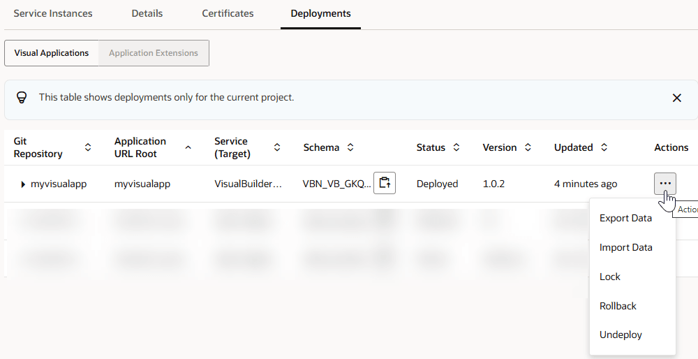

If your visual application was deployed to a Visual Builder instance in the same identity domain as your VB Studio instance, you can manually lock and unlock the application from your environment’s list of deployments:
In the VB Studio left navigator, click Environments
If necessary, select the environment where the visual application was deployed to, then click Deployments.
From the deployed application’s Actions
menu, select Lock, then confirm your selection:
Take note of the application’s Status, which changes from Deployed to Deployed (Locked). Users accessing a web app from this visual application should now see a message that the application is locked for maintenance.
