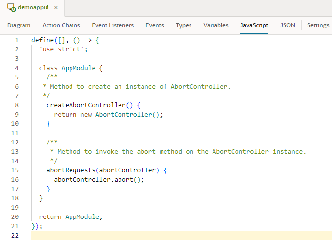

  1. To use the AbortController API, you first need to create an AbortController instance. You also need to call the abort method on the AbortController instance that's created. We'll do this by adding two app-level JavaScript functions that can be used across your App UI's pages.
    1. Select your App UI node, then click JavaScript to open the app-level JavaScript editor.
    2. Add this JavaScript snippet to the editor:
         * Method to create an instance of AbortController.
        createAbortController() {
          return new AbortController();
         * Method to invoke the abort method on the AbortController instance.
        abortRequests(abortController) {
          abortController.abort();
      Your JS editor might look something like this:
      Description of abortcontroller-js-snippet-appui.png follows

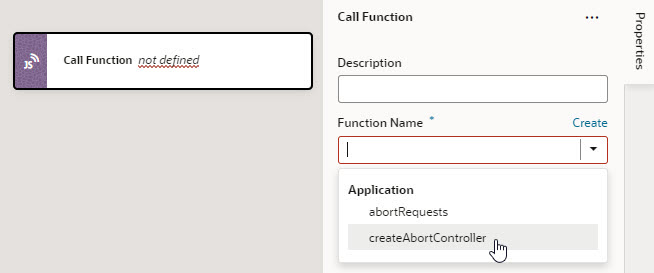

    6. From the Actions palette, drag a Call Function action onto the canvas.
    7. In the action's Function Name property, select createAbortController under Application to call the JS function that creates an AbortController instance.

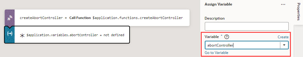

    8. Now drag and drop an Assign Variable action to follow the Call Function action.
    9. In the Assign Variable action's Properties pane, select abortController under Application from the Variable list.
    10. Hover over the Value property and click Select Variable to open the Variables picker, then select createAbortController under Local to assign the value returned by the createAbortController function to your abortController variable.

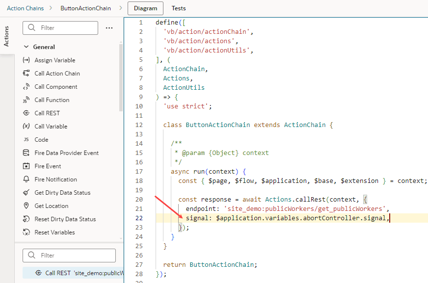

  4. Associate the AbortController with the REST call you want to abort. You do this by attaching the AbortSignal of an AbortController instance to the REST request via the signal option. For example, to abort the Get/publicWorkers/{publicWorkers_Id} endpoint request, you attach the AbortSignal to the Call REST action in the action chain underlying the button component (which is ButtonActionChain in our example).
    1. Open the action chain that uses the Call REST action in the Action Chains editor. Because our example assumes a Call REST button on a page, this Call REST action exists in the ButtonActionChain action chain defined at the page level.
    2. Click Code to switch to code view.
    3. Locate the code snippet for the particular Call REST action and add this line after the endpoint constructor:
      signal: $application.variables.abortController.signal,
      In this example, the AbortSignal is accessed via $application.variables.abortController.signal and attached to the get_publicWorkers REST request:
      Description of abortcontroller-abortsignal-appui.png follows

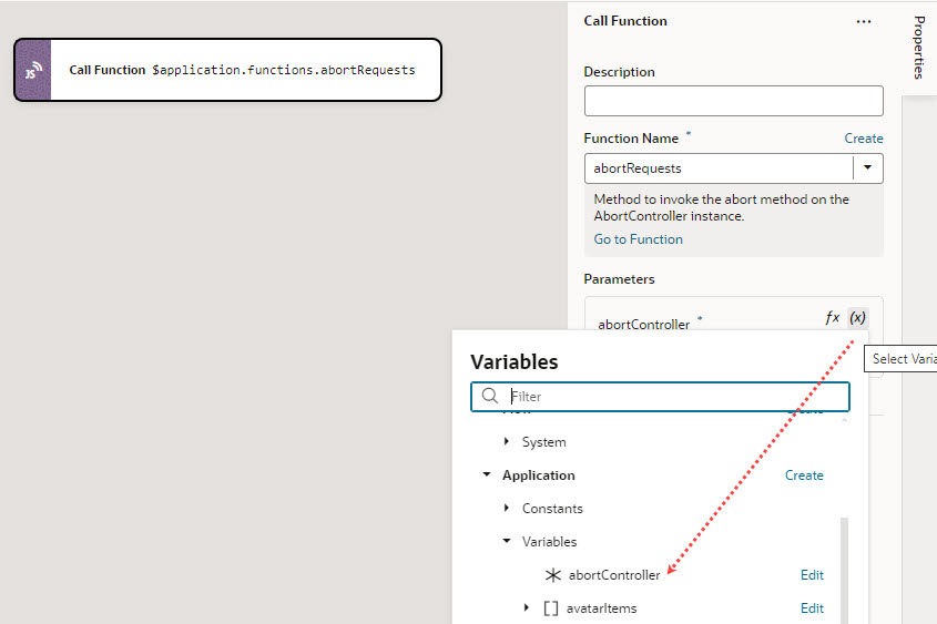

    3. From the Actions palette, drag a Call Function action onto the canvas.
    4. In the action's Function Name property, select abortRequests to specify the JS function that calls the abort method on the AbortController instance for the specific REST request.
    5. To pass your abortController variable as an input parameter to the abortRequests function, locate the abortController under Parameters, hover over the parameter to open the Variables picker, then select abortController under Application.

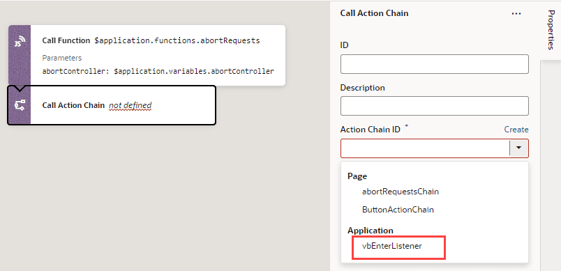

    6. Calling the abort method on an AbortController instance permanently aborts any future requests, so you need to create a new AbortController instance and assign it to the abortController variable. To do this, drag and drop a Call Action Chain action and select the vbEnterListener action chain (which was created for you in step 3 to do both) in the Action Chain ID list.
