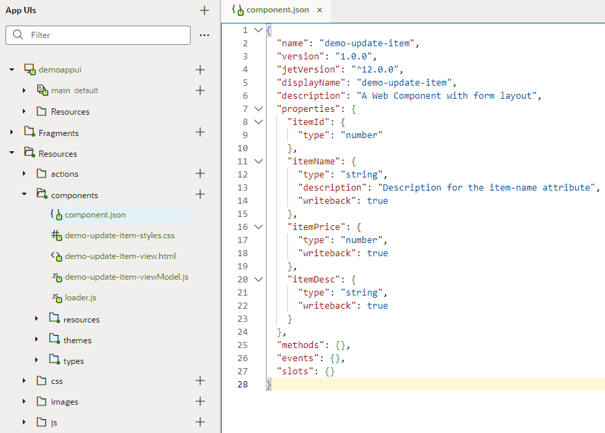

Oracle JavaScript Extension Toolkit (JET) web components are reusable pieces of user interface code that you can embed as custom HTML elements. You can create a web component from a template that comes with VB Studio.
When you use the Create Component dialog box to create a component, the new component contains the JavaScript, HTML, style sheet, and JSON files required. The files contain sample code to help you get started. After you create the web component, you can click the component artifact in the Navigator to edit each of the component’s files.
To create a web component:
- Expand the global Resources node in the Navigator.
- Click Create Component (
) next to the components node. - Type the ID for the component in the Create Component dialog box. Click Create.
