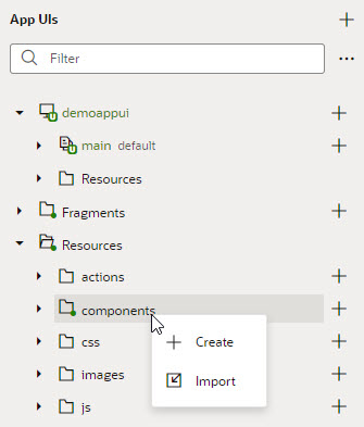

  1. Select the App UIs tab.
  2. Expand the global Resources node.
  3. Right click the components node to bring up the context menu and select Import.

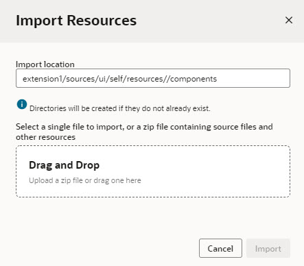

  4. Upload your ZIP archive in the Import Resources dialog box by dragging it into the Drag and Drop area or by clicking the area and locating the file in your local system. Click Import to finish.
The imported web component is displayed in the list of components in the Components palette, under the category specified by the component’s metadata. After importing the web component, you can position it in your page and configure its properties in the Properties pane as you would a standard component.
