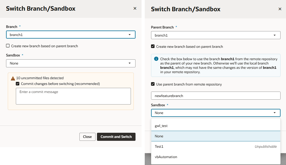

You use the Switch Branch/Sandbox dialog to switch branches or create a new branch from a parent branch that you select, or, optionally, switch from one sandbox to another.
  1. Click the Git menu in the header or in the Git panel.
    You can also click the Sandbox menu in the header.
  2. Select Switch Branch/Sandbox.
    The Switch Branch/Sandbox dialog displays the current branch in the Branch drop-down list and the number of uncommitted files, if any.
  3. Choose the appropriate option:
    • To switch branches, select the branch that you want to switch to.
    • To create a new branch, select Create new branch based on parent branch and enter the name for the new branch.
      If the selected parent branch exists locally as well as in the remote repository, select Use parent branch from remote repository to use the remote branch as your new branch's parent. You'd typically want to do this if the remote branch is more current than the local branch. Otherwise, the local branch will be used.
    • To associate this branch with a new sandbox, choose one from the Sandbox drop-down. Some sandboxes might be marked "Unpublishable", which means they either have dependencies that haven't been resolved or were created without the ability to publish. Avoid choosing an unpublishable sandbox, as doing so is likely to break your extension.
  4. Click Commit and Switch (or Switch if you cleared Commit changes before switching (recommended)).
