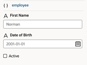

When working with a fragment in the Page Designer, the fragment’s Properties pane by default displays text field components for editing the values of fragment variables enabled as input parameters. For some input parameters, a different UI component can make editing the parameter easier or more intuitive. For example, if a parameter is used to specify a date, a Date Picker component might be easier to use than a text field. To do this, you customize the fragment variable, so that a date picker shows instead of a text field when the fragment’s input parameters are edited in the Page Designer:
Description of fragment-variable-pi.png follows

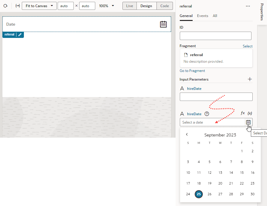

    To display a date or date-and-time picker:
    For a string-type variable or constant:
    1. In the Design Time tab, select the Subtype as Date or Date Time.
    2. Optional: In the Placeholder field, specify a hint text for the variable; for example, Select a date .
    3. Optional: In the Minimum field, set the bottom (inclusive) limit of a date or date-and-time range for the value in the Properties pane.
    4. Optional: In the Maximum field, set the top (inclusive) limit of a date or date-and-time range for the value in the Properties pane.
    5. Optional: Switch to the General tab, then in the Label field, enter a user-friendly name for the variable.
    Description of fragment-variable-date.png follows

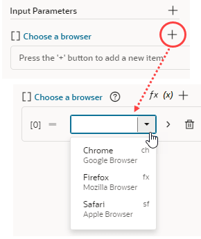

    To display a drop-down menu containing an array of possible values:
    1. In the Design Time tab, select the Subtype as Enum Values.
    2. Optional: In the Placeholder field, specify a hint text for the variable; for example, Select the default browser .
    3. Click Add icon next to Enum Values, enter the Label, Value, and Description for your first value. For example, you might enter Chrome as the label, ch as the value, and Google Browser as the description. Click Create.
      If you want to make changes, click Edit icon , update the values, and click Save. Click Delete icon to delete a value.
      To reorder your list, drag the Reorder icon next to the value and drop it where you want it.
    4. Repeat step c to create your entire list of values.
    Description of fragment-variable-enumvaluepng1.png follows

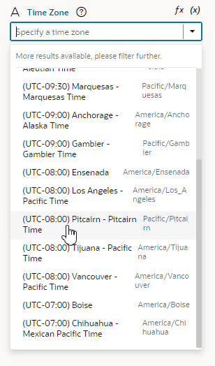

    To display a drop-down menu with a list of time zones:
    1. In the Design Time tab, select the Subtype as Time Zone.
    2. Optional: In the Placeholder field, specify a hint text for the variable; for example, Select a time zone .
    3. Optional: Switch to the General tab, then in the Label field, enter a user-friendly name for the variable.
    Description of fragment-variable-timezone1.png follows

When you set properties in the Design Time tab, the metadata in the fragment’s JSON is automatically updated. You can open the JSON editor to view the metadata. For example, here’s what you might see for a variable that is customized to use the Date Picker component:
"variables": {
    "hireDate": {
      "type": "string",
      "input": "fromCaller",
**   "@dt": {
        "label": "Date of Hire"
        "subtype": "date",
        "valueOptions": {
          "placeholder": "Select a date"

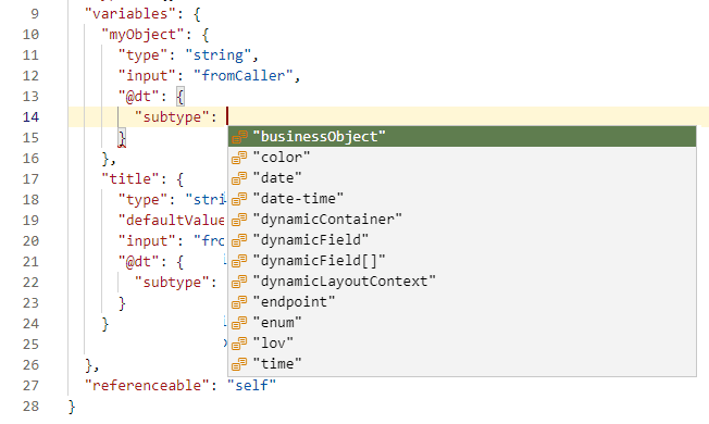

Customize Fragment JSON with Metadata
While you can use a fragment variable’s Design Time tab for some simple UI customization, you’ll need to edit the JSON directly for advanced options. To do this:
  1. Open the fragment’s JSON editor.
  2. Update the variable or constant’s definition by setting the @dt element, then use the subtype property to specify the component you want displayed in the Page Designer. The JSON editor displays a hint to help you select the value for the subtype property:
    Description of fragment-variable-json.png follows

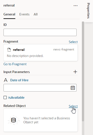

    For example, here’s how you can show a component for selecting a business object by setting the subtype property to businessObject:
    "myObject": {
       "type": "string",
       "@dt": {
             "subtype": "businessObject",
             "label": "Related Object"
    You can also use the label property to change the variable’s display name in the Properties pane.
    The Properties pane in the Page Designer will now show a component for selecting a business object and the new display name for the variable wherever the fragment is used.
    Description of fragment-variable-bo.png follows

subtype Available subtypes:
  • businessObject
  • color
  • date
  • date-time
  • endpoint
  • enum
  • lov
  • time
  • timezone
Other subtypes are also available, but they are used to set the binding type and do not affect how the variables are displayed in the Properties pane. For details on using dynamicContainer , dynamicField , dynamicField[] , and dynamicLayoutContext , see Set the Binding Type for Variables in Dynamic Components. For details on using businessObjectValue and businessObjectValueReference , see Resolve Expressions in Page Properties Based on Fragment Data.

The fields property can be used to customize how the object is displayed:
    "variables": {
        "employee": {
            "type": "person",
            "defaultValue": {
                "active": false,
                "date-of-birth": "2001-01-01",
                "name": "Norman"
                "@dt": {
                    "valueOptions": {
                    "fields": [ {
                        "id": "name",
                        "description": "The first (given) name"
                        "label": "First Name"
                        "id": "date-of-birth",
                        "label": "Date of Birth"
                        "subType": "date"
                        "id": "active",
                        "description": "Is the employee active?"
                        "label": "Active"
The customized object would look similar to this in the Properties pane:
Description of designer-constants-pi-fields1.png follows

If you are using an array of primitives (say, string[])), you can use enum to display a drop-down menu showing all values for each item in the array:
    "selectBrowser": {
      "type": "string[]",
      "@dt": {
         "subtype": "enum",
         "valueOptions": {
            "values": [
                "value": "ch",
                "label": "Chrome",
                "description": "Google Browser"
                "value": "fx",
                "label": "Firefox",
                "description": "Mozilla Browser"
                "value": "sf",
                "label": "Safari",
                "description": "Apple Browser"
            "placeholder": "Select the default browser"
          "label": "Choose a browser"
The Properties pane will show a drop-down menu with the three values for each item in the array:
Description of fragment-variable-enumvalue-array1.png follows

businessObject
placeholder
Use the businessObject subtype to display a business object picker in the Properties pane.
    "type": "string",
        "@dt": {
The Properties pane displays a component for selecting a business object:
Description of fragment-variable-bo-cropped.png follows
The placeholder valueOption is not displayed in the Properties pane when you use the businessObject subtype.
