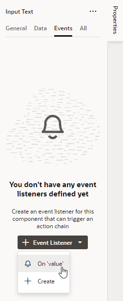

  3. Select the Events tab, click the New Event button, and select on ‘value’:
    Description of filter-input-event.png follows
    A new action chain is created and associated to the event. You’re now taken to the Action Chain editor to implement the action chain for filtering. See Use Filter Builder to Create Filter Criteria for an SDP on how to create the action chain using an Add Variable action.

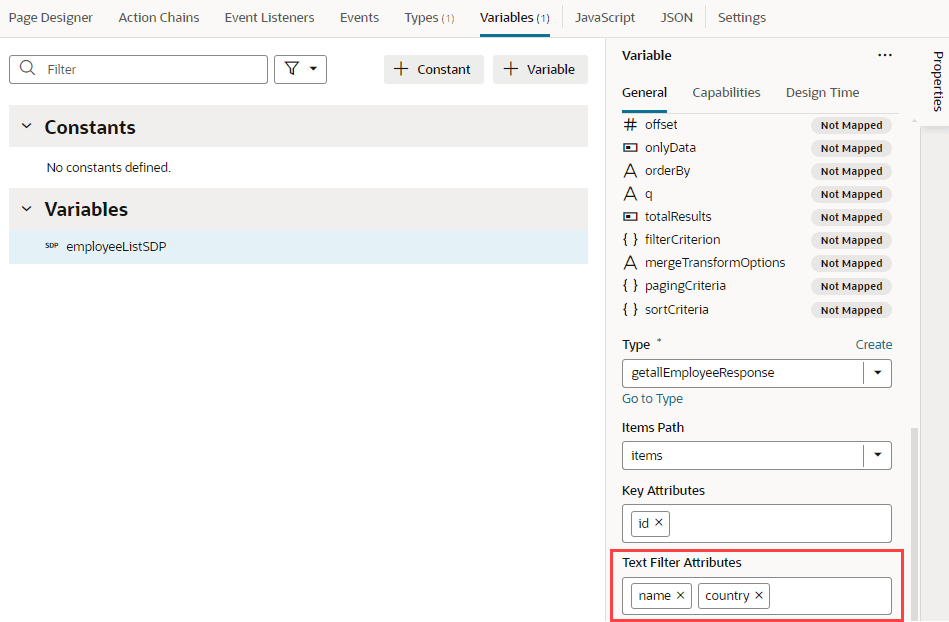

To achieve this, you need to configure the TextFilterAttributes property on the SDP variable used to bind the component to an endpoint. For example, your Select Single component might use the employeeListSDP variable to request and receive data from the getall_Employees endpoint. This variable is usually created for you when you use the Add Data Quick Start to bind a component to an endpoint and can be found on the page’s Variables tab. Update the variable’s TextFilterAttributes property to specify one or more data fields, for example, name and country:
Description of text-filter-attributes.png follows
A list that’s based on an SDP doesn’t hold a client-side array of data, so filtering is done by sending a “q” query string to the endpoint. The endpoint returns the matching values to the client, populating the SDP. So now if the user were to enter us in the Select Employee field, VB Studio searches for values in the Name and Country fields that match us. The results (as shown here) include three employees who belong to the Country USA as well as one employee whose name includes those letters:

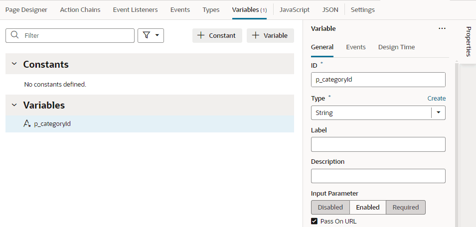

  1. Click the Variables tab for your page.
  2. Click + Variable, then update the ID as needed and select the Type.
  3. Set the Input Parameter to Enabled or Required and select Pass On URL.
    Description of url-create-variable.png follows

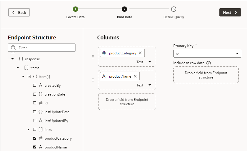

  6. On the Add Data page, specify the business object you want to use and click Next.
  7. On the Bind Data page, bind the fields you want to display and click Next.
    Description of url-bind-data1.png follows

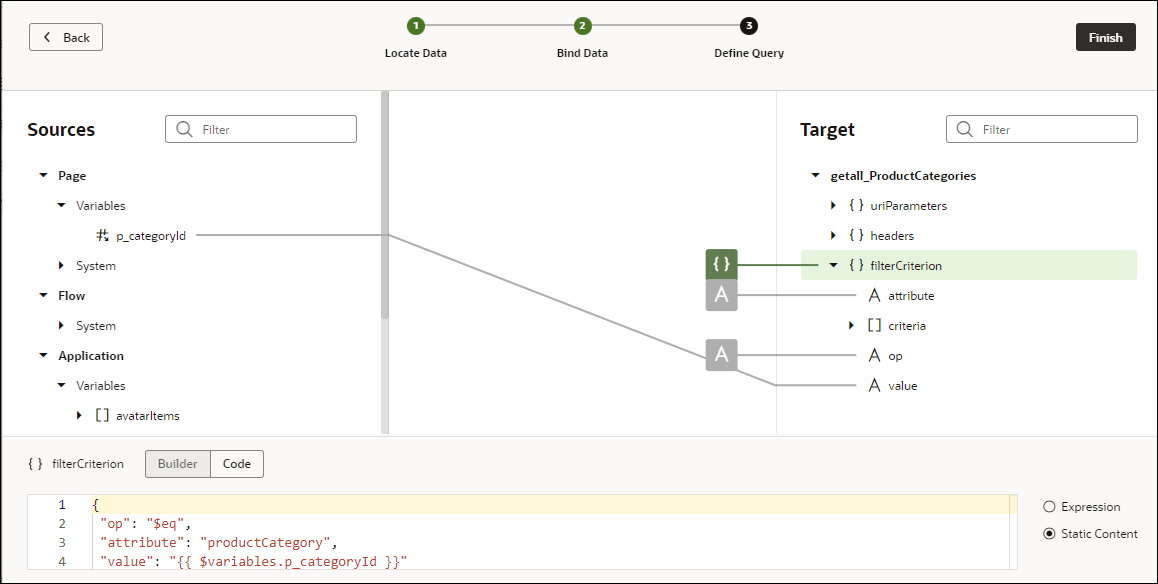

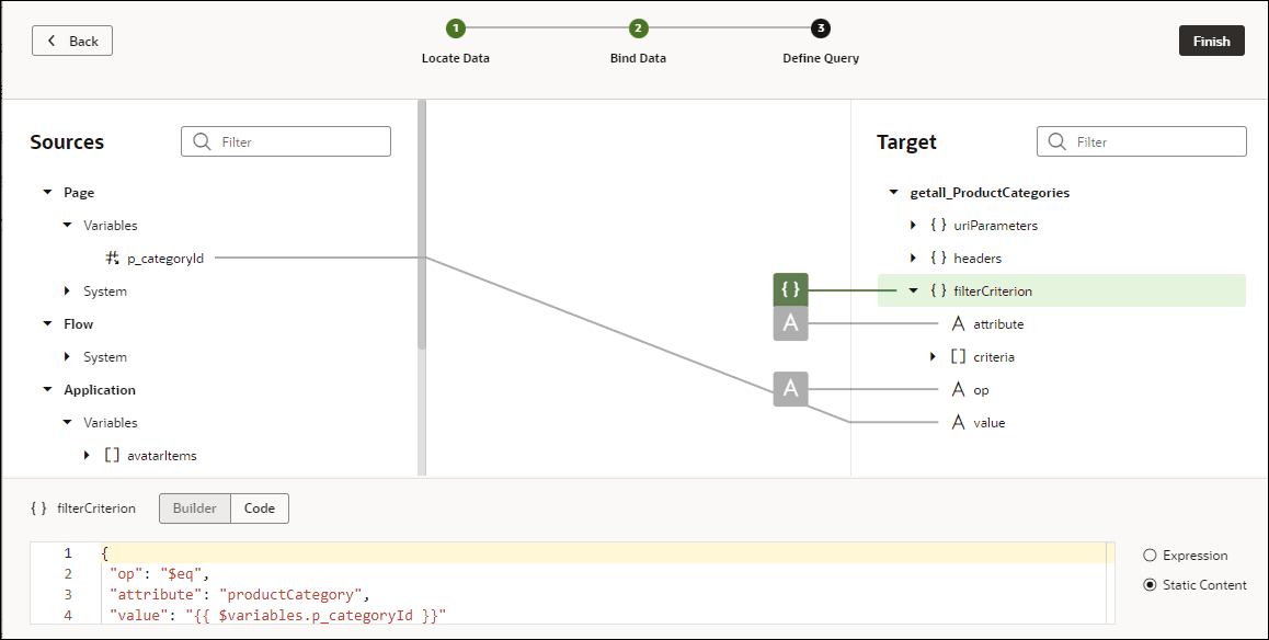

  8. On the Define Query page of the quick start, expand the filterCriterion builder icon on the Target pane and build your filter by specifying values for attribute, op, and value individually.
    Description of url-attribute.png follows
  9. Click Finish.

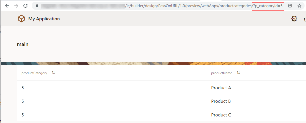

To filter the table, add ?paramName=Value to the end of the app URL.
Description of url-add-parameter.png follows
