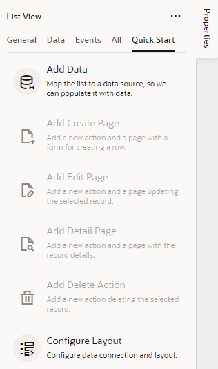

So how would you know if a quick start is available for what you want to do? Just look for the Quick Starts tab in a selected component's Properties pane when designing pages in the Page Designer. The Quick Starts tab will display a list of tasks that are typically used to add functionality or behavior to the selected component. These tasks are based on common tasks that developers need to do when creating the App UI's pages. For example, here's a list of quick start tasks available for you when you are working with a List View component:
You'd start, for example, with the Add Data quick start to populate the list with data from your data source (typically, a GET MANY
REST endpoint). Once that's done, other quick starts that let you generate other pages or set up functionality are enabled for you. Typically, you'd select one or more data source endpoints to fetch data and select the fields you want to show in those pages. When your data source is a service with expected endpoints (such as GET
