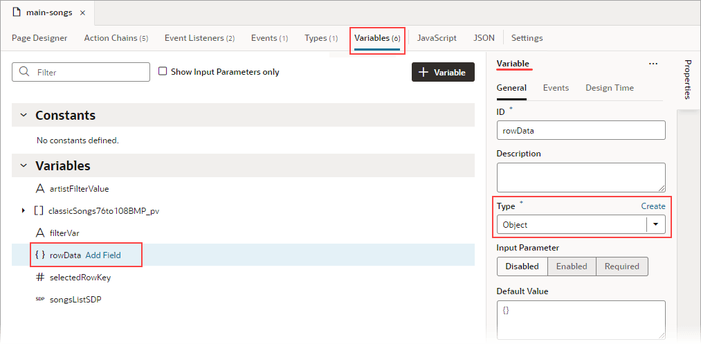

  1. Create a page variable of type Object to hold the selected row’s data:
    Description of jsac-create-rowdata-variable1.png follows

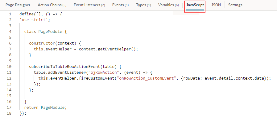

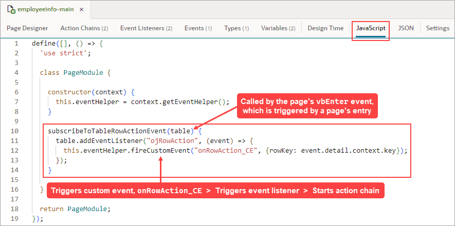

  2. Create a JavaScript function (module function) to subscribe to the table’s ojRowAction event, which is triggered when a user clicks a table’s row. You’ll use this ojRowAction event to trigger your custom event, which will start the action chain that saves the row’s data to the rowData page variable.
    To create the function, select the JavaScript tab. Use the context’s eventHelper object’s fireCustomEvent() method to trigger your custom event and to pass the required payload. The event parameter contains the row’s data (event.detail.context.data).
    Description of jsac-js-function-subscribe-table-event.png follows
    Here’s the example code:
    constructor(context) {
        this.eventHelper = context.getEventHelper();
    subscribeToTableRowActionEvent(table) {
        table.addEventListener("ojRowAction", (event) => {
        this.eventHelper.fireCustomEvent("onRowAction_CustomEvent", {rowData: event.detail.context.data});

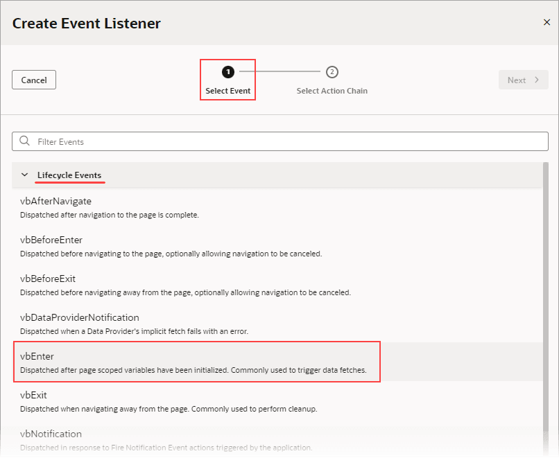

  3. Create the event listener for the page’s vbEnter event, which is triggered when the page starts. You’ll use this event listener to start an action chain that calls the function to subscribe to the table’s ojRowAction event.
    1. Select the page’s Event Listeners tab, then click + Event Listener.
    2. In the Select Event step, select vbEnter under Lifecycle Events and click Next.

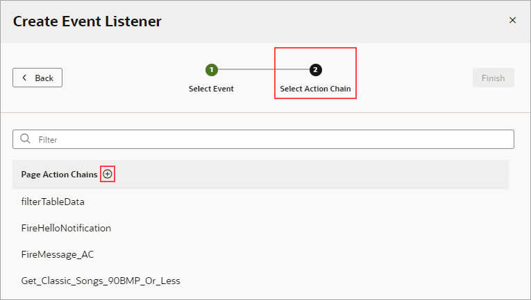

    3. In the Select Action Chain step, click the Add icon next to Page Action Chains.
      Description of jsac-create-event-listener-create-action-chain1.png follows
      Description of the illustration jsac-create-event-listener-create-action-chain1.png

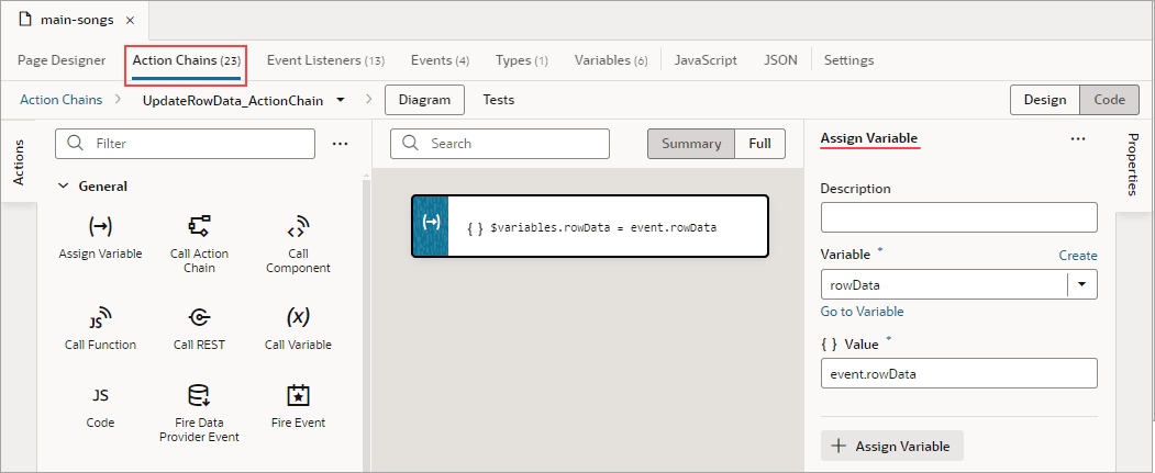

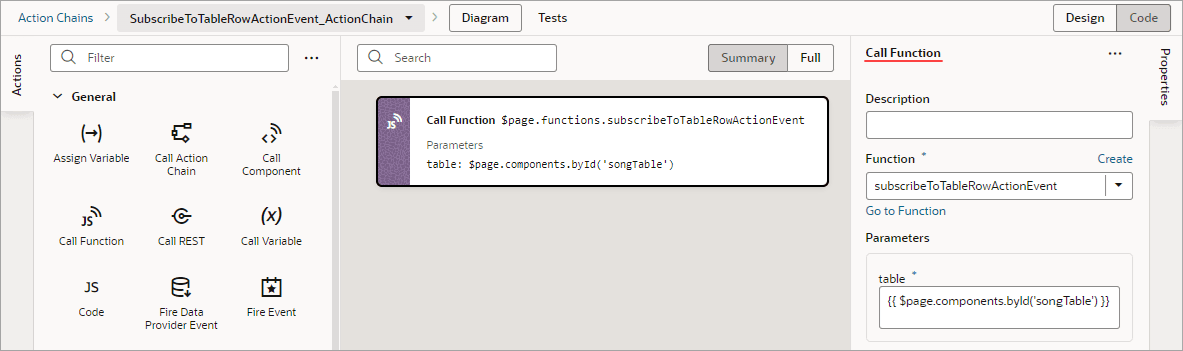

  4. Create the action chain to call the function that subscribes to the table’s ojRowAction event. Add the Call Function action to the canvas. Set its Function Name property to the JavaScript function, and pass the table to the function using the table parameter:
    Description of jsac-call-subscribe-function-action-chain.png follows
    Description of the illustration jsac-call-subscribe-function-action-chain.png

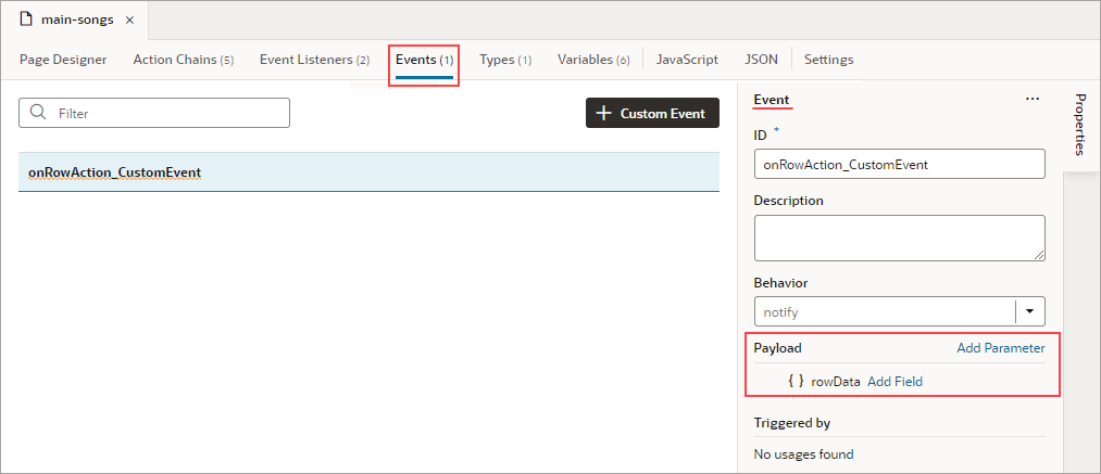

  5. Now create the custom event that will be triggered by the table’s ojRowAction event. You’ll also create the action chain that assigns the row’s data to the rowData page variable.
    1. On the page’s Events tab, click + Custom Event to create a custom event. In the Properties pane, click the Payload property’s Add Parameter link and define an input parameter of type Object. This input parameter will be used to pass the row’s data to the action chain that assigns the data to the rowData page variable.
      Description of jsac-create-custom-event1.png follows
    2. For the custom event’s Behavior property, set whether the action chain runs serially or in parallel. The default, notify, is in parallel. For details about each option, see Choose How Custom Events Call Event Listeners.

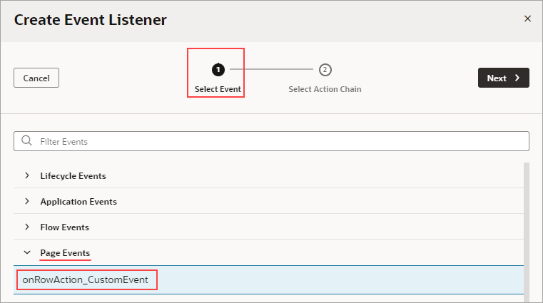

  6. Create an event listener for the event to specify which action chains to start when the event occurs (more than one action chain can be started by an event listener).
    1. On the page’s Event Listeners tab, click + Event Listener.
    2. In the Select Event step, scroll down to Page Events and select the custom event that you created. Click Next.
      Description of jsac-create-event-listener-select-event1.png follows
      Description of the illustration jsac-create-event-listener-select-event1.png
      When a listener’s action chain is created here, if the listener’s custom event has input parameters, the action chain is created with an event input parameter. This event object contains the custom event’s input parameters (example: event.param1, event.param2...), and the event object is automatically passed to the new action chain.
    4. In the Action Chain editor, note that the action chain has the event input parameter, which contains the custom event’s input parameter. Add the Assign Variable action, set its Variable property to the page variable that will contain the row’s data, then set its Value to the relevant value in the event object that was passed to the action chain:
      Description of jsac-create-action-chain-event-listener1.png follows
      Description of the illustration jsac-create-action-chain-event-listener1.png
