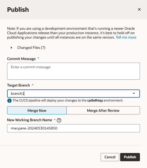

    The Publish operation combines Git operations (commit, push, merge) to merge the changes in your local repository branch into the target branch you select. Your screen should now look something like this:

  2. If changes exist, enter a comment in the Commit Message area to describe your changes and commit them. A commit groups the changed files and provides a description to identify the group.
  3. In the Target Branch field, select the branch in the remote repo to merge to.
    The first branch in this list is always the repository's default branch, main, conveniently followed by the last 10 branches you created merge requests for (if any). Any remaining branches follow in alphabetical order. This flexibility lets you more easily publish and test your new feature development work, if you're not yet ready to merge those changes into your repository's main branch.
  4. If you land on the Merge Now tab, the New Working Branch Name field displays with an automatically populated new name for your working branch. You can accept the default, but it's recommended to change to a name that's more meaningful.
    Once you publish a branch, you can no longer use it (or your local copy of it). Instead, VB Studio automatically creates a new working branch using the value in this field, and switches your workspace to it for any future changes.
  5. If you'd rather get someone to review your changes via a merge request, click the Merge After Review tab. After entering a comment summarizing your changes, you can then specify other details such as reviewers and linked issues as needed. You can also enter a description of all your changes (not just this commit) in the Merge Request Description field, using the convention established for the template (Markdown, Confluence, or Textile). If you need help, use the link to the associated reference.
    Note that the New Working Branch Name field doesn't display because, if a merge request is created, VB Studio won't automatically create a new working branch and switch your workspace to it. After the merge request is approved and your extension is published, however, you should manually switch the workspace to a new working branch.
    If you see only the option to commit and merge your changes via a merge request (that is, there's no Merge Now tab), that means the project owner or an administrator has set things up so that all changes must always be reviewed and approved via a merge request before they are merged to the target branch. In this case, summarize your changes in the Publish dialog, add at least one reviewer (if no one is specified), and specify the related issue in order to create a merge request. (Once the request is created, you can look for it on the Merge Requests page. For details on how to work with merge requests, see Review Source Code with Merge Requests in Using Visual Builder Studio.)
    If a merge request is required but a CI/CD pipeline hasn't yet been set up, the dialog will display a message indicating that the Publish action will only merge your changes; to fully deploy your extension, you'll need to first set up a pipeline for the remote branch. See Deploy Changes from a Different Branch in Administering Visual Builder Studio.
  6. Click Publish.
    Tip:
    Use the details in the Publish dialog to take note of the environment that your changes will be published to, which is typically the deployment target specified in the pipeline that's enabled for the selected target branch.
