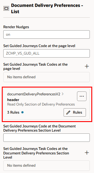

    Locate the component you want to edit in the Properties pane, or select the component on the page to open the component’s details pane in the Properties pane.
    If the component’s rule set has any rules with conditions, you might see something like this in the Properties pane. Click Rules to open the rule set editor:
    Description of express-ruleset-multiplerules.png follows
    In the example above, the rule set has three rules, including the default rule.

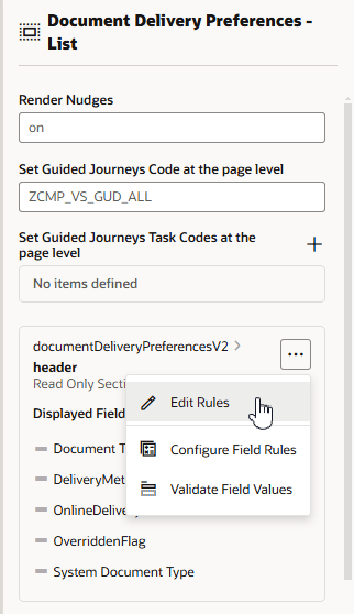

    If you see something like this in the Properties pane, select Edit Rules in the options menu to open the rule set editor:
    Description of express-ruleset-editrules.png follows

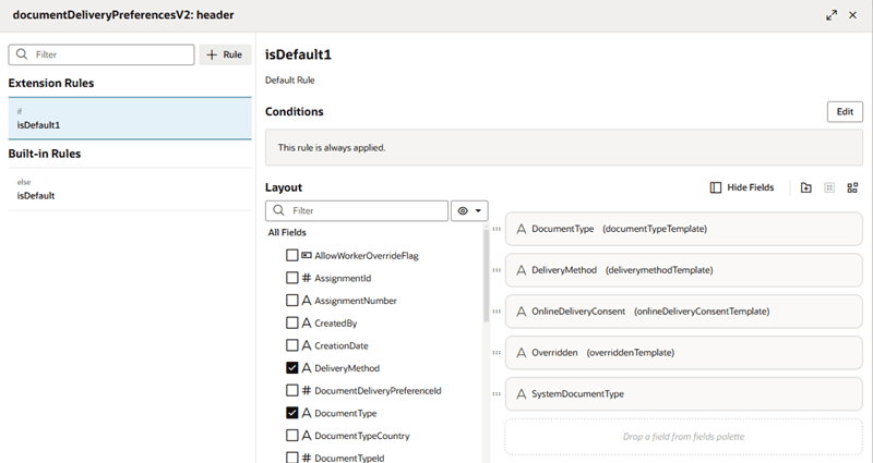

    Let’s look at the rule set for a form layout as it appears in the editor:
    Description of express-ruleset-editor.png follows
    The left pane of the editor lists the rule set’s rules. A rule set always has one built-in default rule (isDefault) that is always applied. (In this example, the list also contains a rule isDefault1 that is created automatically if you edit the layout in the Properties pane.)
    To the right, the selected rule’s conditions are displayed above the list of available fields and the fields displayed with the rule:

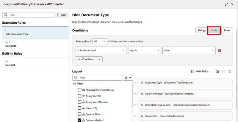

  5. Select the rule in the Extension Rules list, then click Edit to open the condition builder and define its conditions.
    The condition builder is the same one used to create conditions for extension rules in business rules. You can click Code to write the condition in the code editor. If you’re not familiar with using the condition builder, see Set Conditions for a Rule.
    Description of express-ruleset-conditionbuilder.png follows
    Click Done to close the condition builder. Your changes are automatically saved.

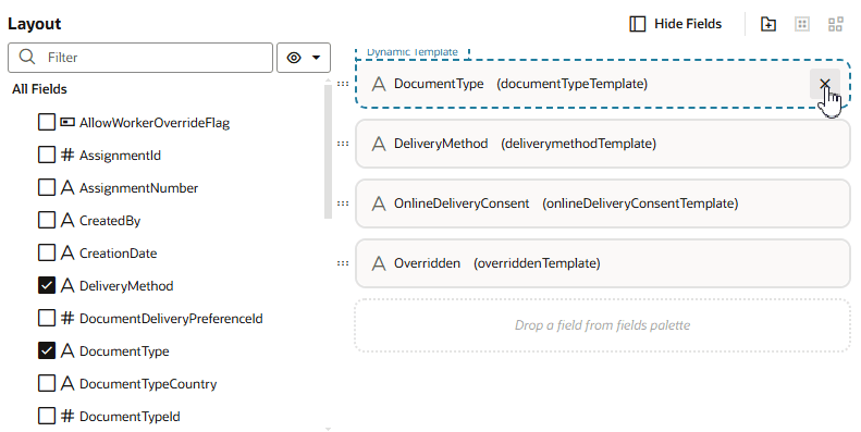

  6. In the Layout pane, select the fields you want displayed in the component when the rule is active.
    Add a field or object to a layout by selecting the checkbox next to the field, or by dragging it from the list into the layout. To delete a field, you can deselect its checkbox in the Fields palette, or click X in the layout:
    Description of express-ruleset-editlayout.png follows
    The layout editor contains a Fields palette listing all the fields that can be displayed in the layout. If the palette is hidden, click Show Fields. You can click Hide Fields in the toolbar to hide the Fields palette.

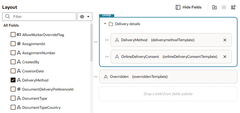

  7. (Optional) Group fields by selecting all the fields that you want to include in the group, either by holding down the CMD key (on macOS) or the Ctrl key (on Windows), and then clicking Group Fields in the toolbar.
    The selected fields are grouped under a folder in the list. You can type a name for the new folder in the layout editor:
    Description of express-ruleset-groupfields.png follows
    You use groups to divide a dynamic form into different sections. Each subsection has a heading based on the group name.
    To ungroup the fields in a group, select the group and then click Ungroup in the toolbar.
