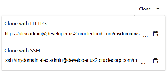

Access Files in a Git Repository’s Private Branch
To access a Git repository’s private branch, configure the job to use SSH:
  1. On the computer that you’ll use to access the Git repository, generate a SSH key pair and upload its private key to VB Studio. See Upload Your Public SSH Key. Make sure that the private key on your computer is accessible to the Git client.
    Ignore this step if you’ve already uploaded the SSH public key.
  2. Copy the Git repository’s SSH URL.
    On the Git page, from the Repositories drop-down list, select the Git repository. From the Clone drop-down list, click Copy to clipboard the Copy icon and copy the SSH URL:
