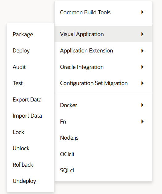

To configure these options in a packaging job:
- In the left navigator, click Builds
In the Jobs tab, select the packaging job and click Configure.
A visual app includes a default
Visual-Application-Packagebuild job that packages the visual application’s sources. - On the Job Configuration page, click Steps.
Click Add Step, select Visual Application and select the option you want to add to the job:
Each of these option has its own set of parameters. Some operations should follow a particular order. For example, the Audit and Test steps should be performed before the Package step, and all three must precede the Deploy step.
See the following for more information about each option:
