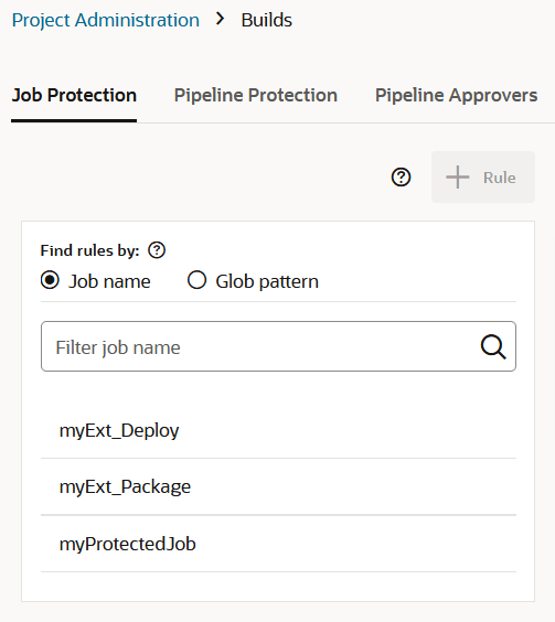

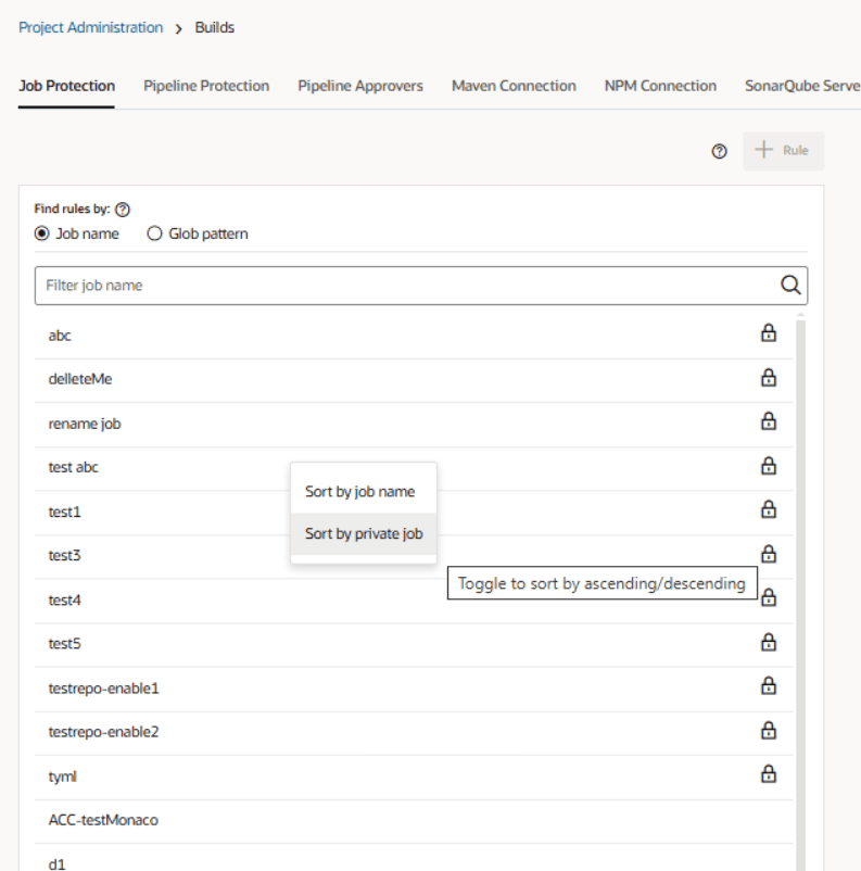

  4. In the Find rules by panel, located above the jobs/rules list, select one of these radio buttons:
    • Select Job name to choose a job from the list.
      If your project has many jobs, you may have difficulty finding the specific job you want to protect. Use the Filter job Search icon bar to quickly locate the job to which you want to add the restricted settings.
      Right-click the jobs list to display additional sorting options. Click Sort by job name or Sort by private job to sort the list accordingly. Re-click the sorting option to toggle between ascending and descending order.
      Job protection page sorting options

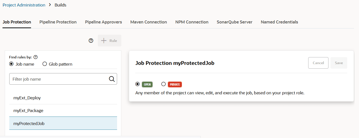

      If a job has a lock icon Lock icon , it has already been protected. A protected job's restrictions can still be modified, removed, or the list of authorized users and groups can still be changed.
      The Job Protection dialog box is displayed.

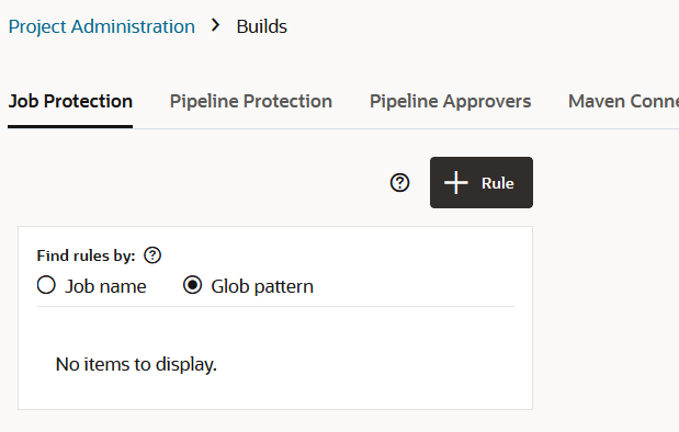

    • Select Glob pattern to specify a string that is matched against the job name.
      This is what you'd see if no rules have been defined yet.

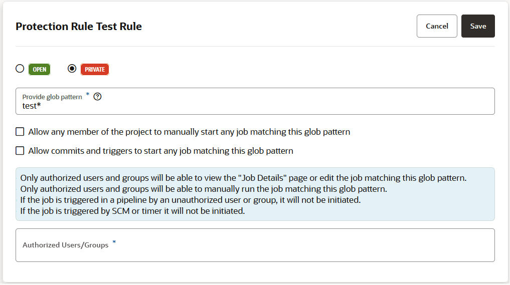

      Either select an existing protection rule from the list or click + Rule to display the New Protection Rule dialog and create a new one.
      The Protection Rule dialog box is displayed.
      Description of protection-rule-dialog-populated.png follows
      Here we've entered a name (Test Rule) and a glob pattern (test*) and we're about to press Create to create a new job protection rule.

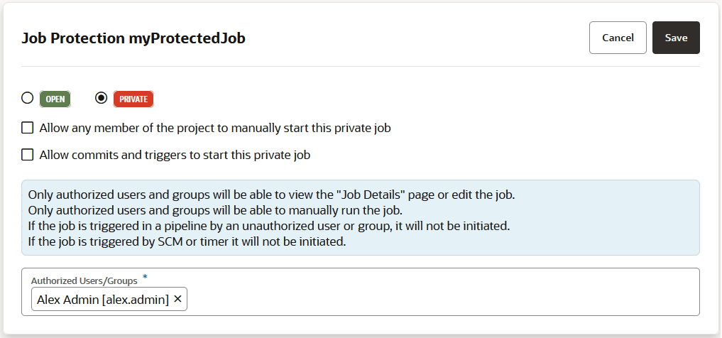

  5. Select the PRIVATE check box.
    This is what you see after selecting the Private option for a job.
    Description of job-protection-private.png follows
    With just this option selected, only authorized users and groups will be able to view the Job Details page, edit the job, or manually run it. If the job is triggered in a pipeline by an unauthorized user or group, or if it is triggered by SCM or a timer, it will not be initiated.

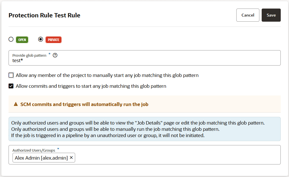

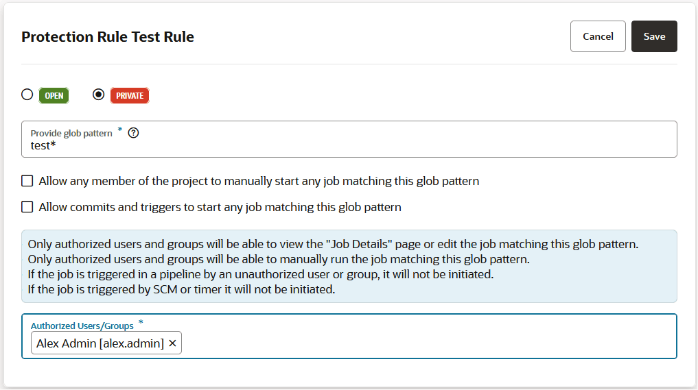

    This is what you see after selecting the Private option for a protection rule.
    Description of job-protection-rule-private.png follows

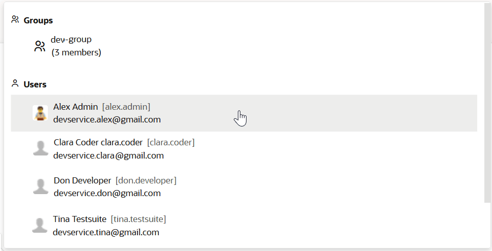

  6. Click in the Authorized Users/Groups field to display a dialog that lists the project's Groups and Users you can select from.
    Under Users, you can see a flattened list of all users that are members of the group(s) as well as ones that were added individually. For example, the dev-group members (Clara Coder, Don Developer, and Tina Testsuite) appear in the Users list, along with Alex Admin, who was added individually. From the list, select one or more groups and/or users. Don't forget to add yourself.
    Description of authorized-groups-users.png follows

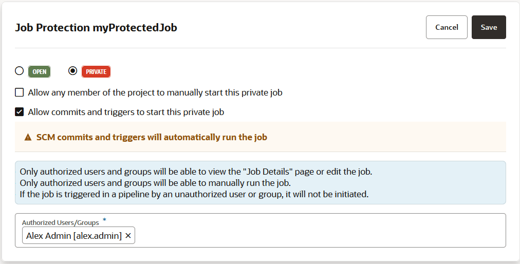

    This is what you would see for the myProtectedJob job after selecting Alex Admin as an authorized user.
    Description of job-protection-private-authorized-user.png follows
    This is what you'd see for the Test Rule protection rule after selecting Alex Admin as an authorized user.

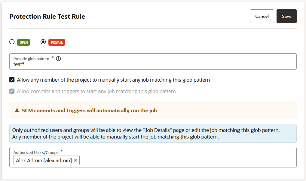

  7. Select the checkboxes to allow project members to manually start private jobs and/or allow commits and triggers to automatically start private jobs:
    • Select the Allow any member of the project to manually start this private job checkbox to allow any project member, not just authorized users, to manually start the job.

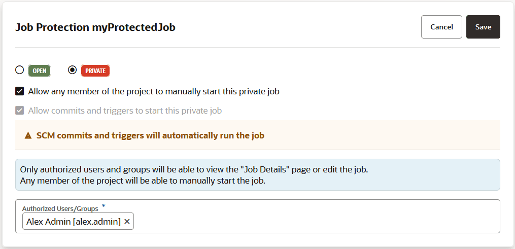

      This what you'd see after selecting the Allow any member of the project to manually start this private job check box for the myProtectedJob job.
      Description of job-protection-private-both-checkboxes-selected.png follows
      Description of the illustration job-protection-private-both-checkboxes-selected.png
      Notice that when you select the first checkbox, VB Studio automatically selects the second checkbox, which allows commits and triggers to start the private job, and grays it out. With this setting, only authorized users and groups can view the Job Details page or edit the job, but any project member can start and run the job. In addition, SCM commits or triggers will also automatically start and run the job.
      This what you'd see after selecting the Allow any member of the project to manually start this private job check box for the Test Rule protection rule.

    • Select just the Allow commits and triggers to start this private job checkbox if you want SCM commits and triggers to be able to automatically run this job.
      Description of job-protection-private-allow-commits-triggers.png follows
      Description of the illustration job-protection-private-allow-commits-triggers.png
      With just this checkbox selected, periodic triggers will run any job or pipeline, including private jobs set to allow commits and triggers to start the private job. However, if a pipeline includes a private job with this option selected and a non-authorized user attempts to run the pipeline manually, the private job won't run but periodic triggers and SCM commits will.
      Leave the checkbox unselected if you don't want the job to be started when it is triggered by an SCM commit or timer.

      This is what you would see if you selected the Allow commits and triggers to start any job matching this glob pattern for the Test Rule.
      Description of job-protection-page-allow-commits-triggers.png follows
      Description of the illustration job-protection-page-allow-commits-triggers.png
