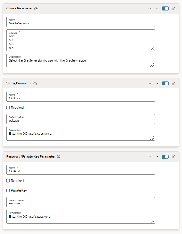

For example, if you want a job to change the default values for the Gradle version, the OCI username, and the OCI user password when a build runs, in a Build step, create the Choice, String, and Password/Private Key build parameters to accept the values. Notice that the value for the Password/Private Key parameter isn’t displayed in the input field.

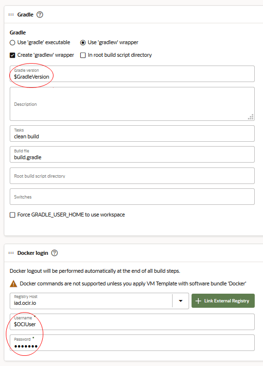

Use the $BUILD_PARAMETER format when you’re using build parameters. (The ${BUILD_PARAMETER} format can be used too.) For example, this screen shot shows the Gradle version, OCI username, and OCI password parameters used in the build step fields of a job. Notice that the password/private key parameter’s variable name isn’t displayed:

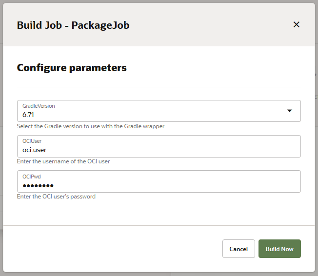

When a build runs, the Configure Parameters dialog opens where you can enter or change the default values of parameters. All parameter values, except the Password/Private Key parameter’s value, are displayed as string in the dialog box, and subsequently in the build log. This screenshot shows the dialog for a job configured to use a password parameter:

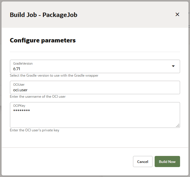

This screenshot shows the dialog for a similar job configured to use a private key parameter instead of a password parameter:
Notice the difference between the OCIPkey private key parameter’s default value (asterisks) and that for the OCIPwd password parameter’s default value (black dots) shown in the previous screenshot.
