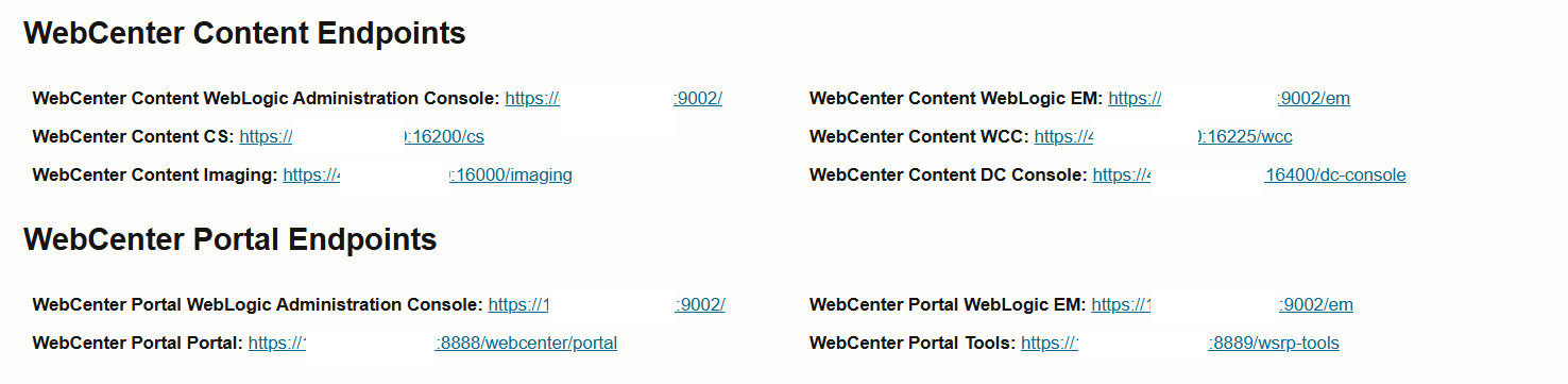

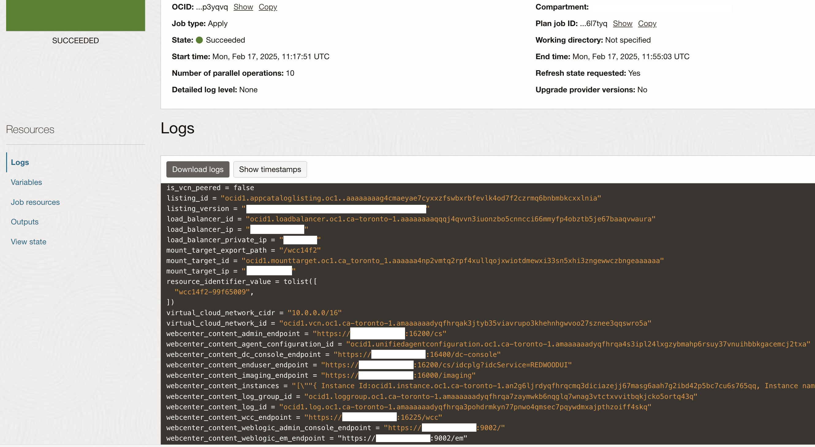

WebCenter Portal Endpoints
If everything goes as expected, then navigate to the WebCenter Portal stack and click the Application Information tab. You'll see all the provisioned end points for the services under sections WebCenter Content Endpoints and WebCenter Portal Endpoints:
WebCenter Content WebLogic Administration Console:
"https://<lb-host-IP>:9002/"WebCenter Content WebLogic EM:
"https://<lb-host-IP>:9002/em"WebCenter Content Admin Endpoint:
"https://<lb-host-IP>:16200/cs"WebCenter Content End User Endpoint:
"https://<lb-host-IP>:16200/cs/idcplg?idcService=REDWOODUI"WebCenter Content WCC:
"https://<lb-host-IP>:16225/wcc"WebCenter Content Imaging:
"https://<lb-host-IP>:16000/imaging"WebCenter Content DC Console:
"https://<lb-host-IP>:16400/dc-console"WebCenter Portal WebLogic Administration Console:
"https://<lb-host-IP>:9002/"WebCenter Portal WebLogic EM:
"https://<lb-host-IP>:9002/em"WebCenter Portal Portal:
"https://<lb-host-IP>:8888/webcenter/portal"WebCenter Portal Tools:
"https://<lb-host-IP>:8889/wsrp-tools"
