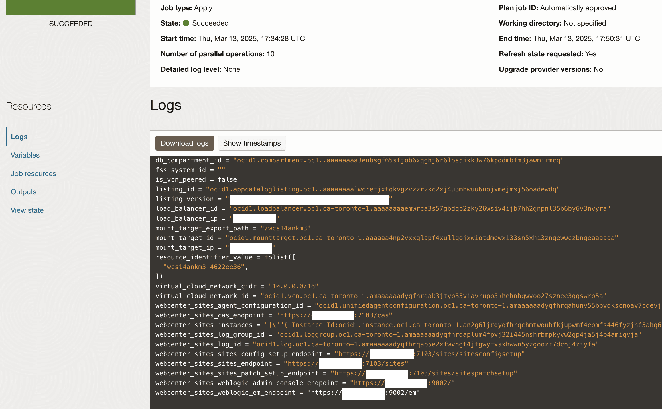

WebCenter Sites Endpoints
If everything goes as expected, then navigate to the WebCenter Sites stack and click the Application Information tab. You'll see all the provisioned end points for the services under section WebCenter Sites Endpoints:
WebCenter Sites WebLogic Administration Console:
"https://<lb-host-IP>:9002/"WebCenter Sites WebLogic EM:
"https://<lb-host-IP>:9002/em"WebCenter Sites Config Setup:
"https://<lb-host-IP>:7103/sites/sitesconfigsetup"WebCenter Sites Patch Setup:
"https://<lb-host-IP>:7103/sites/sitespatchsetup"WebCenter Sites:
"https://<lb-host-IP>:7103/sites"WebCenter Sites CAS:
"https://<lb-host-IP>:7103/cas"

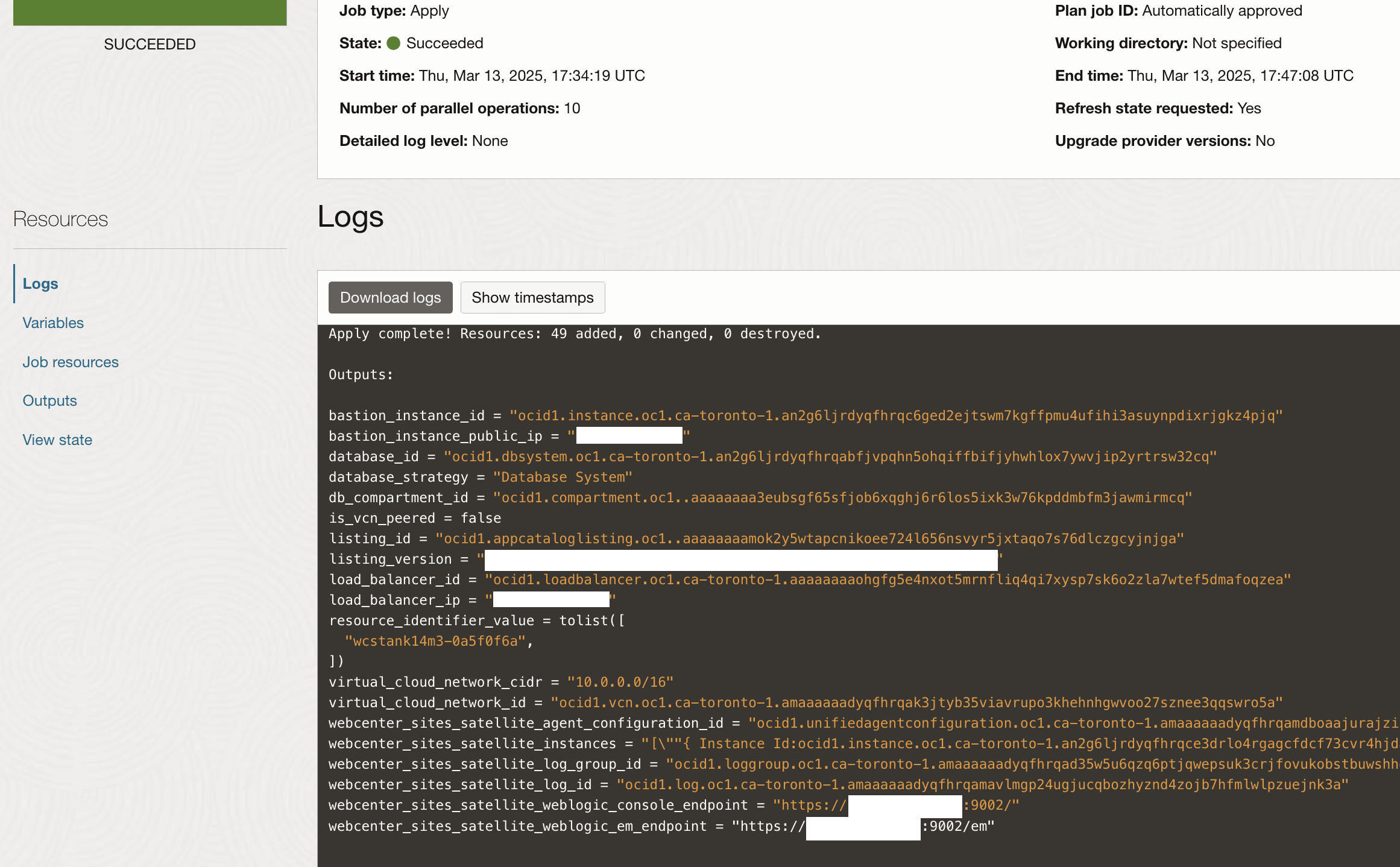

Click Next. Review all the configuration variables and then select the Run apply check box under Run apply on the created stack section. Click Create.

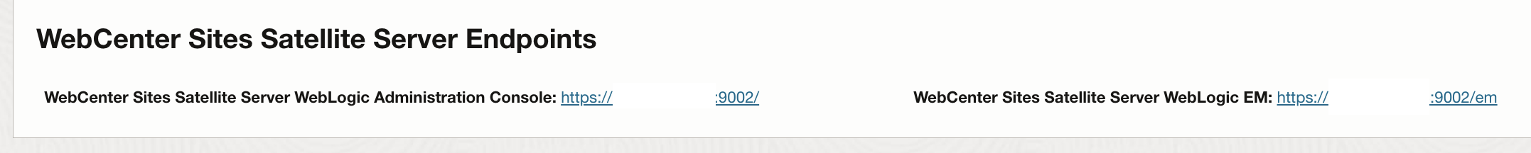

WebCenter Sites Satellite Server Endpoints
If everything goes as expected, then navigate to the WebCenter Sites Satellite Server stack and click the Application Information tab. You'll see all the provisioned end points for the services under section WebCenter Sites Satellite Server Endpoints:
WebCenter Sites Satellite Server WebLogic Administration Console:
"https://<lb-host-IP>:9002/"WebCenter Sites Satellite Server WebLogic EM:
To navigate to the WebCenter Sites Satellite Server stack:
In the side menu, select Developer Services, Resource Manager, and then Stacks.
Select your compartment and click the name of the WebCenter Sites Satellite Server stack you created.
Note: If provisioning fails, check the log at: /u01/data/domains/logs/provisioning.log.
